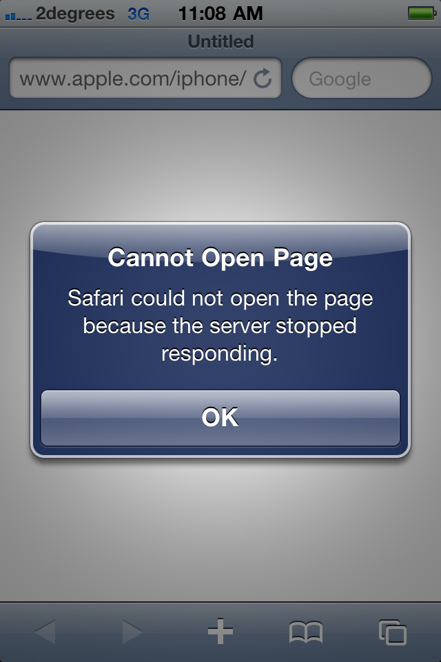

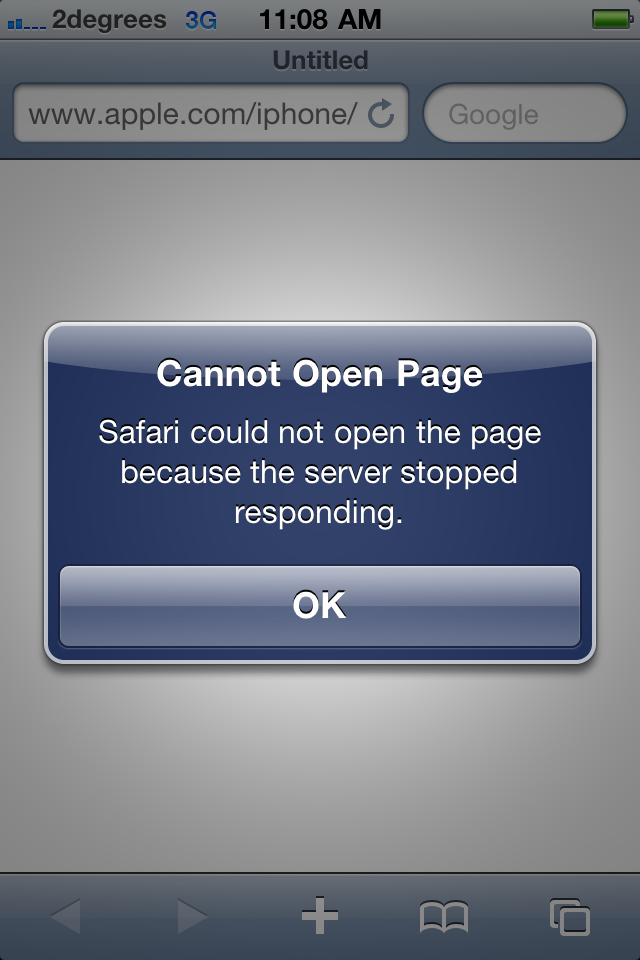

Hey everyone.
I'm the owner of a hacktivated iPhone 4 that was previously on 4.0.1. I restored it to 4.1 this morning with a custom ispw I created with PwnageTool and installed ultrasn0w. However, after I'm on 4.1, My iPhone can no longer access 3G data from my cell provider. I restored it many more times and it still doesn't work. Screenshots attached.

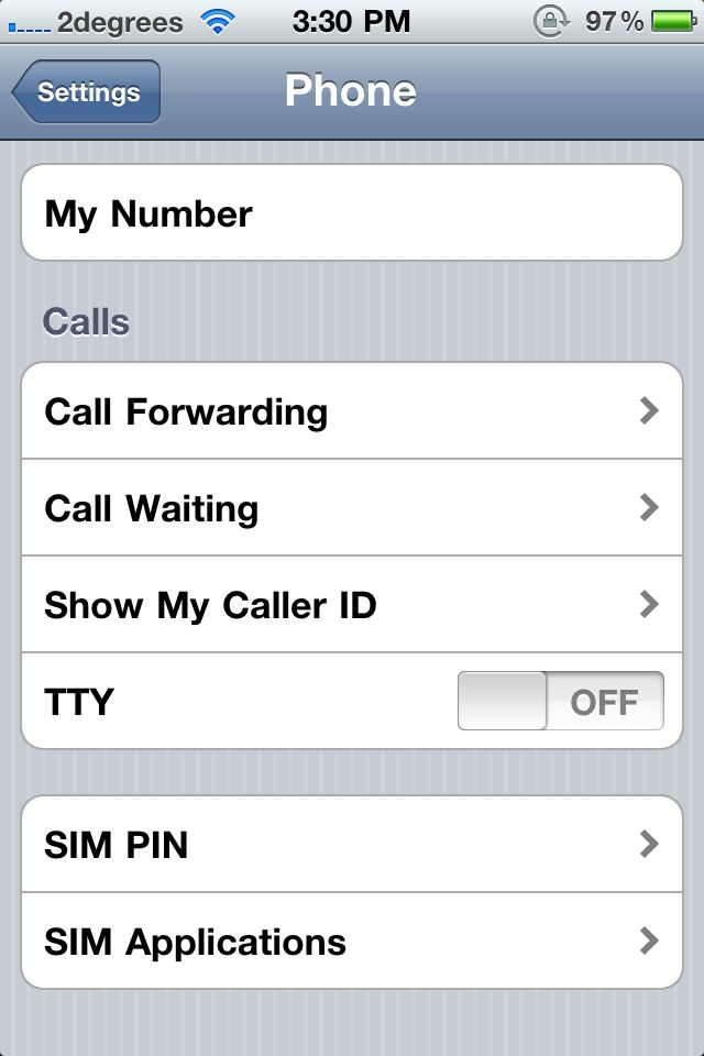

Also, I lost the ability to Facetime. The toggle just doesn't appear in Settings -> Phone. Screenshot also attached.
I've restored 3 times to no avail. Can someone help me? :(

Solution!!
Heya!! I got this problem too, but got the solution.
This happens because a problem with the carrier. Do this…
Open Cydia, go to Manage>Sources> Edit> Add
Add this source: http://cydia.pushfix.info
Now search and install the package "Carrier Reset Fix"
After installing it, take out the SIM Card… and then instert it again.
Now just go to Settings> Phone> FaceTime… and activate it!!
Easy!!
MaxBSan :D

Thank you so much! My 3G works perfectly now. Gotta love being able to tweet everywhere. :D
My FaceTime button appeared, but when I switch it on it's stuck on "waiting for activation"...so this didn't happen to you?
