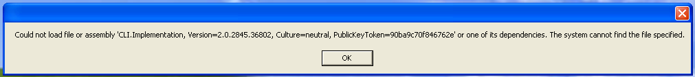

Ok I did the optional install, found the two .NET updates, installed them, REINSTALLED the ATI drivers, and it STILL doesn't work...
here is a screenshot of the error message (it's different than the one I had before, but it changed before I updated the .NET framework)
So you have all three .NET versions then? That definitely looks like it can't find some piece of .NET 'managed code'.
