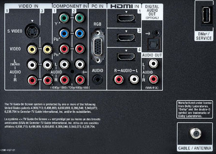

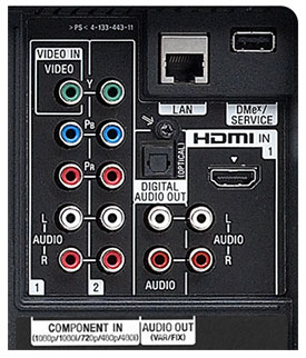

    Do you have the user guide for your TV set? What connections does it have in the first place? It seems to me you are trying to interconnect two digital outputs (toslink input does not emit red light!), which by definition is not supposed to work for your problem setting.
    You see, the outputs and inputs are also labelled as such. You should be looking for a connector named PC/HDMI Audio In or similar:
    3.5mm In for HDMI 4 or VGA
    [​IMG]
    RCA In for HDMI 1
    [​IMG]
    RCA In for HDMI 4, 3.5mm In for VGA
    [​IMG]
