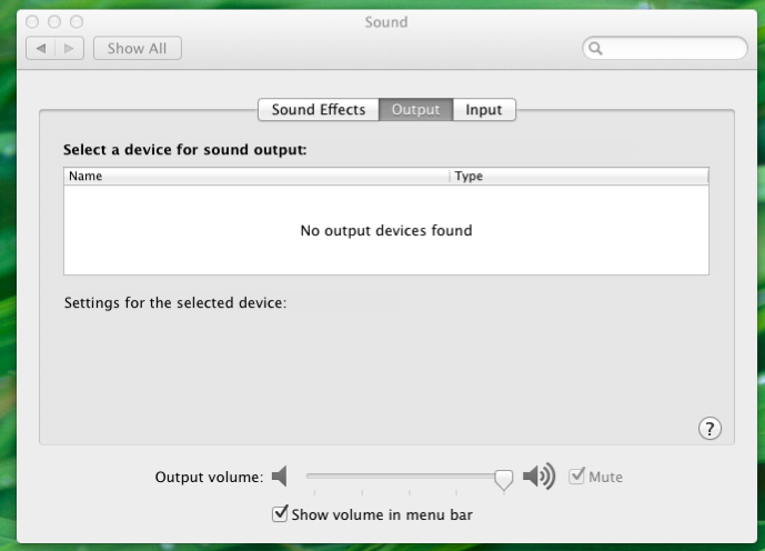

with ML did you check the audio sound output device? maybe it was defaulting to AirPlay?
I already said it does not detect any sound device, internal or external, so there is no airplay or speaker or headphone or anything..

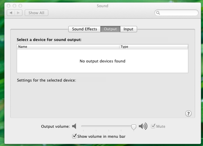

I don't have mountain lion, mountain lion is not compatible with my computer, i have lion 10.7.
(attached is pic of what it looks like in system pref)
