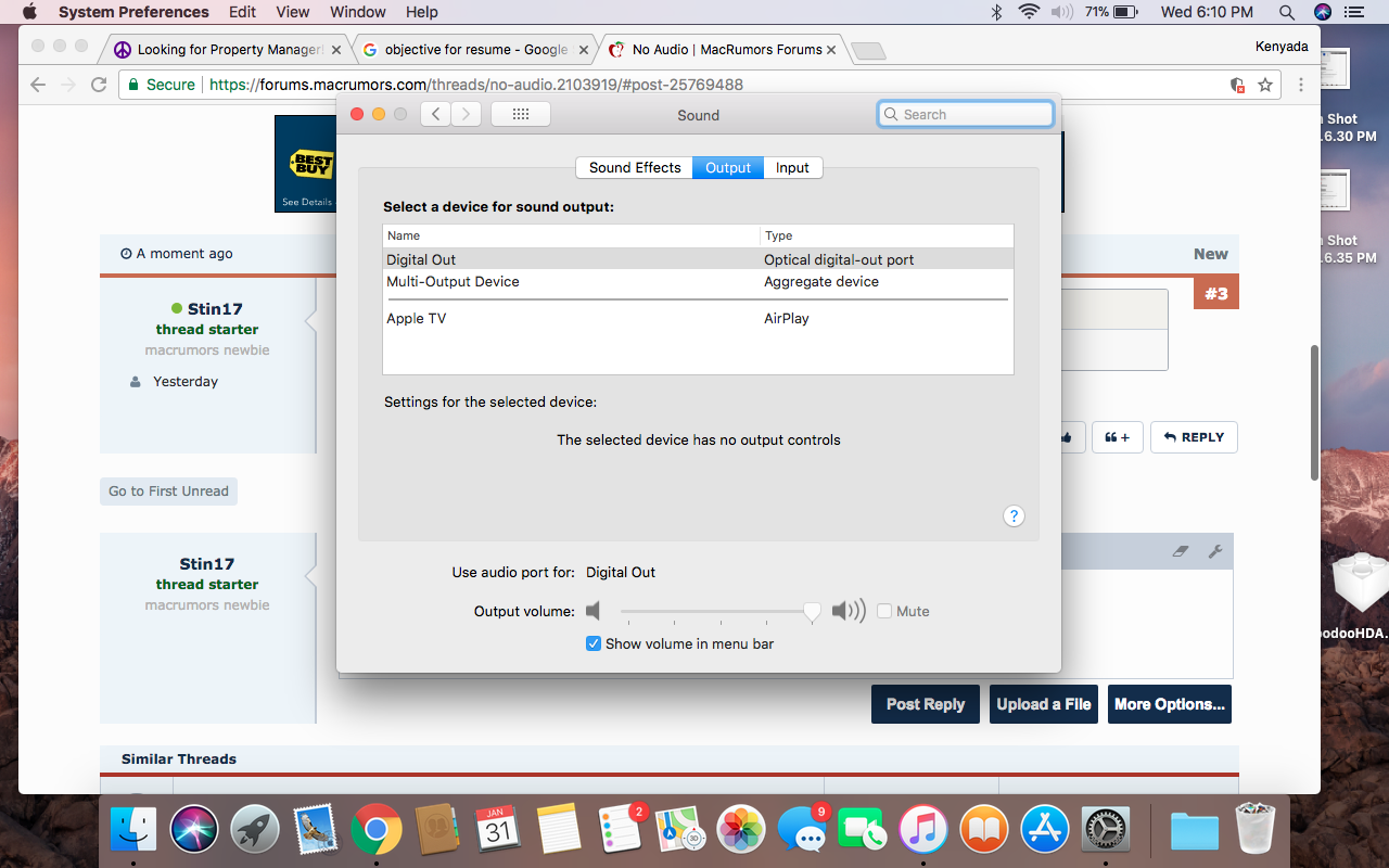

I have a MBP Mid 09. I have tried everything to try and get the internal speakers working. They work when i first turn it on but once it loads up and i sign in when i press the up down or even mute it stays on mute. when i click open and the speaker internal speakers dont it show up. Only way i can get them to work is by plugging some headphones then change it from output to input. soon as i take the headphones out their not working again. Can someone please point me in the right direction on how to fix this please and thank you so very much.

Yes i have. all i have is digital out no internal speaker
[doublepost=1517447479][/doublepost]See
Ah, that means it thinks something is plugged into the audio jack. If you had headphones plugged in there it would indicate that. A digital connection is made of plastic. Something is stuck in there. Usually dust.
Try plugging some headphones in there and removing them to see if that clears it. If not, try blowing into the hole or use a toothpick, but be very careful with that!

If you open the Audio settings and plug in your headphones, it will change from digital to Headphones.
If that is the case, the sensor isn't going back to the original position when the port is empty. It's probably dust that is lodged in there preventing that from happening.
Try rolling up a piece of tape, sticky side out and putting it in there and moving it around. You'll probably get a bunch of dust coming out with it.

Okay i tried the tape trick nothing yet.... Ill continue and i looked at the site ill try that tomorrow also. Ill report back to you the results.. You think there some type of work around that sensor?
