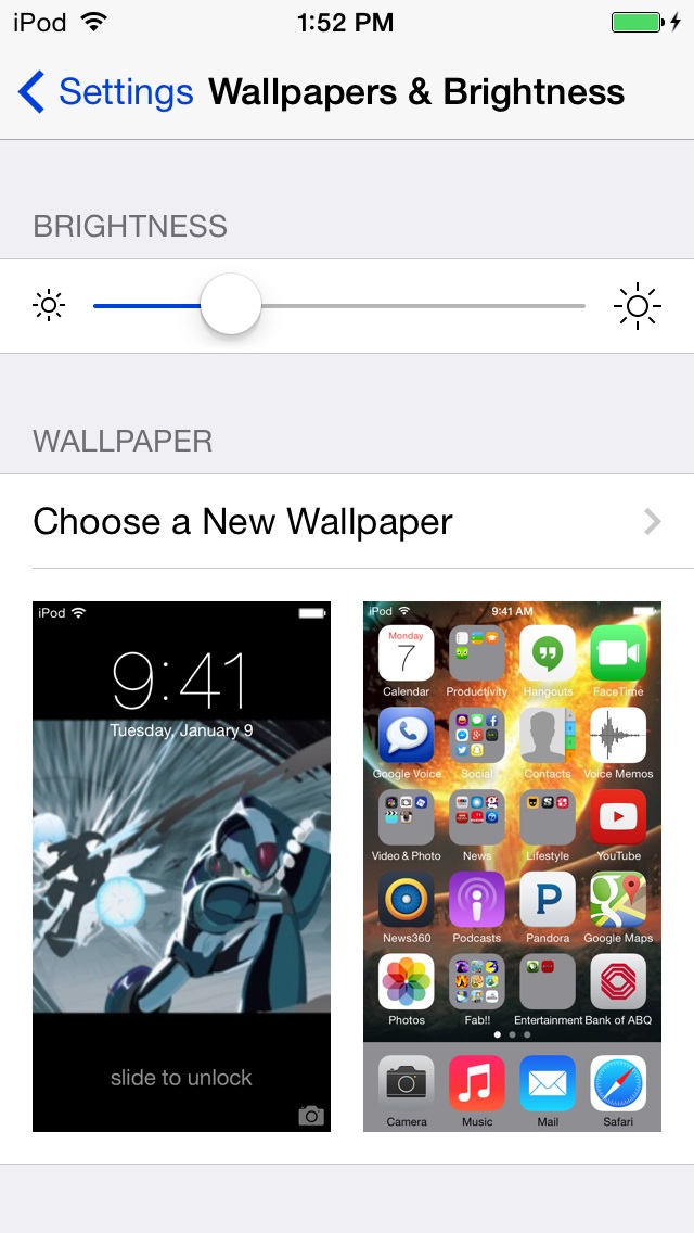

I found my screen stopped auto dimming, went into settings and found I don't have the auto-brightness toggle switch any longer.

Mind posting a screenshot of what you see when you go to Settings, Wallpapers & Brightness? It should be right under the Brightness adjusting bar, and above "Choose a New Wallpaper."
If it's really not there, I'd try a hard reset (hold home and power buttons together until the phone restarts). Then check to see if it's there.
I've definitely tried the reset by holding both the home button and power button.
Here's a screenshot.

Are you sure it had it? I know that all iPods don't actually have the sensor.
This is correct. The 5th generation iPod, the only one that can run iOS 7, does not have an ambient light sensor required for using the auto-brightness feature of iOS.
True, didn't even think the OP could be talking about an iPod (which wasn't clear until the screenshot was posted).
OP, I think this is your answer.
I just upgraded from an iPod 4 which did have the sensor..... 🙁
Oh well, at least I know I'm just not missing it for no reason🙂
Thanks for the replies!
