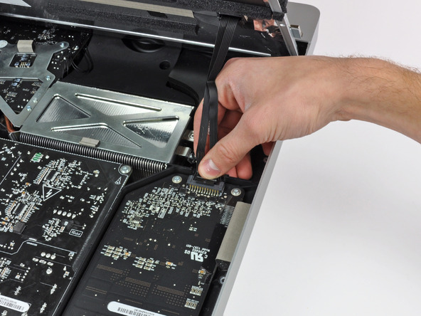

I've just installed an OCZ Vertex 3 as an add-on in my imac 27" 2011 - I followed the guide at chargedpc.com.
But when I switch the computer on, the backlight is suddenly gone. When I shine something at the screen, I see that the screen is displaying something. I think it's my mail programme. But the screen is almost pitch black.
Can anyone help me? What have connected wrongly?
Btw, the fans also rev up. Don't know why, cause the original drive is still there. Please help me 🙁
Check if backlight power cable is properly connected:

Thanks! I Will check that, when I get home. I don't understand, why the fan revs up. A lot of people installed the same ssd without fan trouble. Any ideas?

It was of course because I didn't connect the backlight cable. Stupid!
