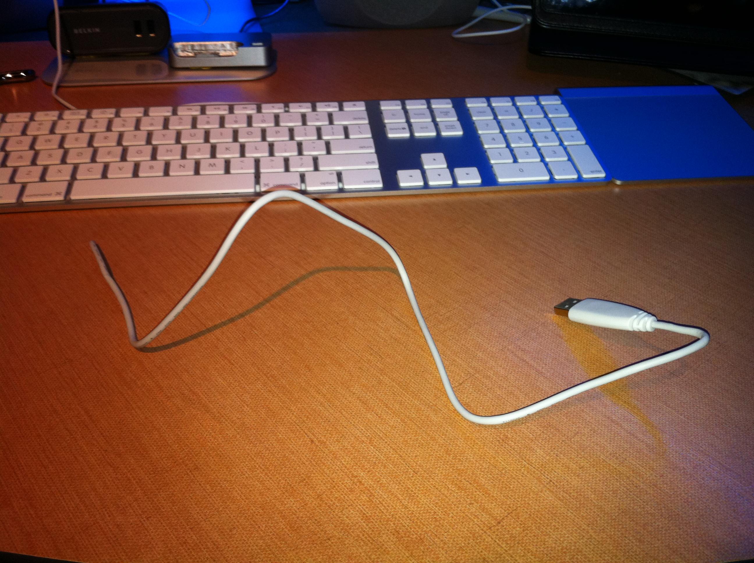

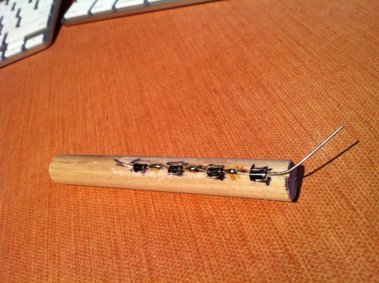

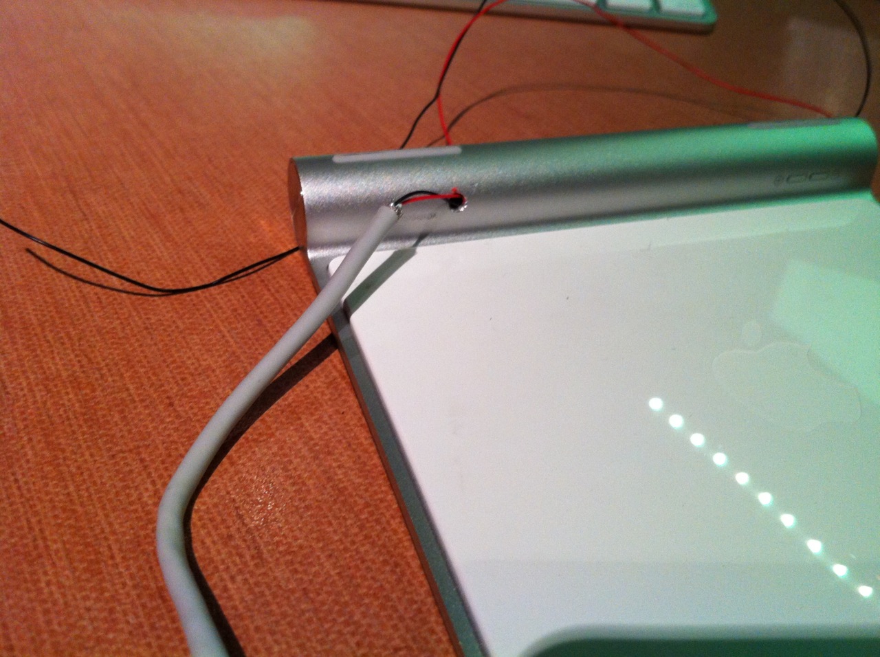

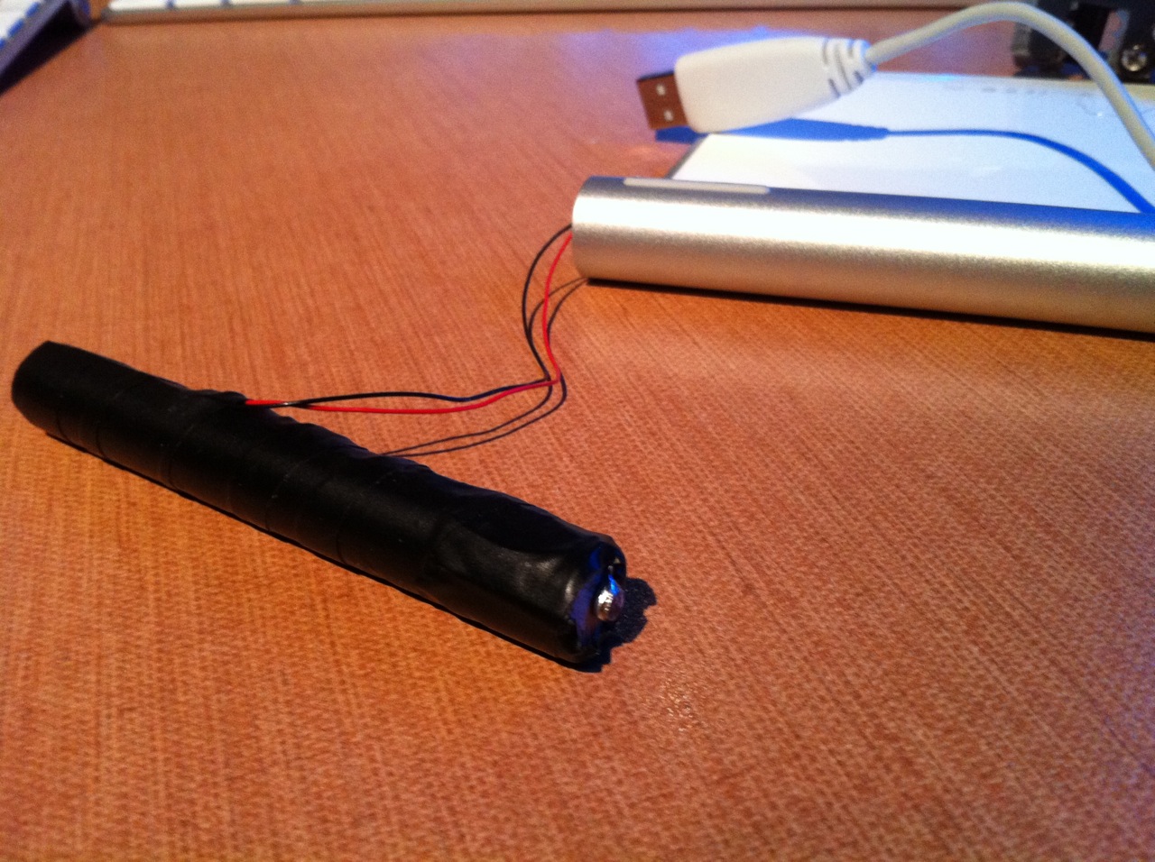

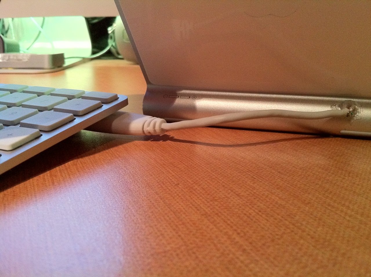

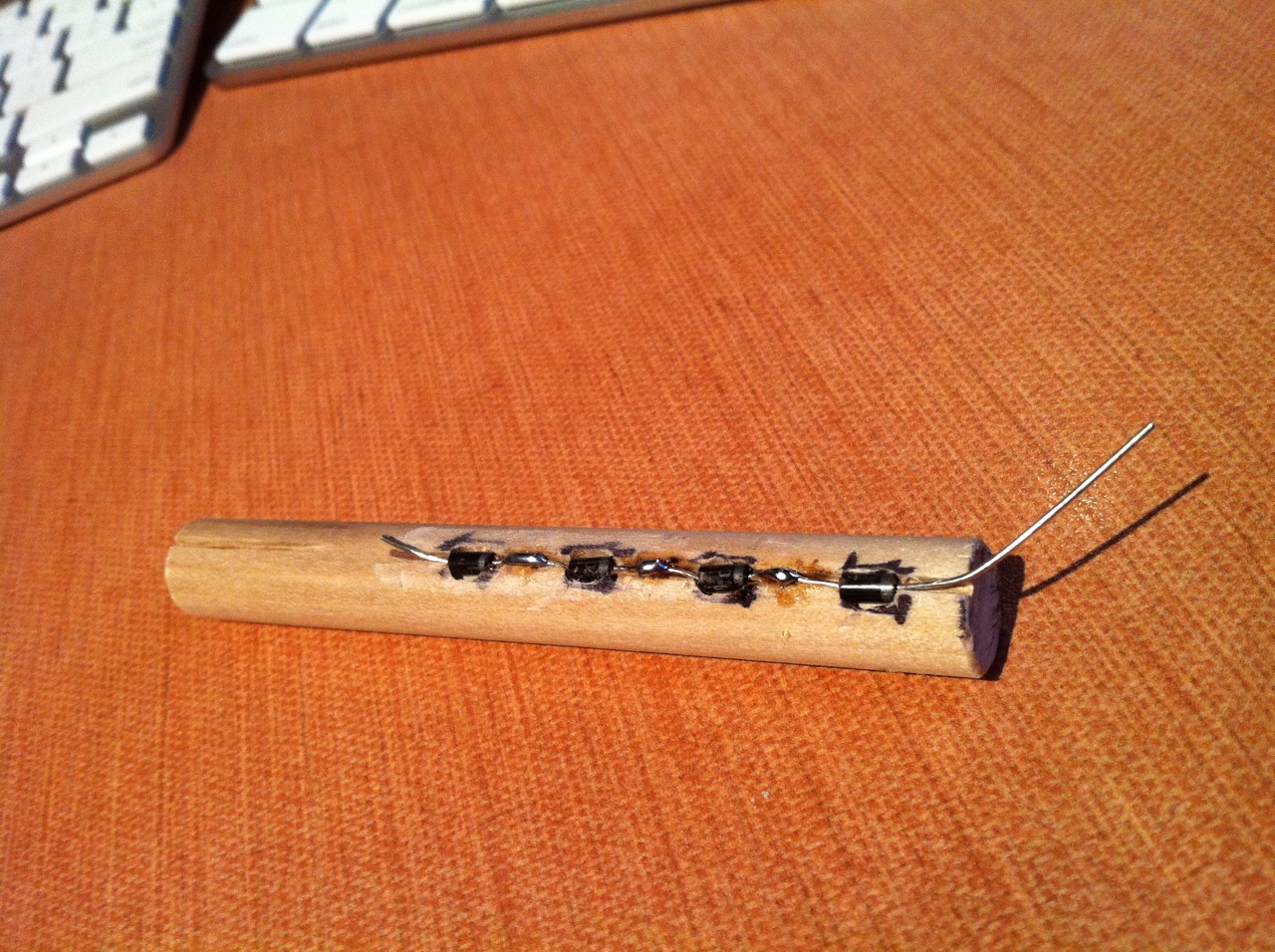

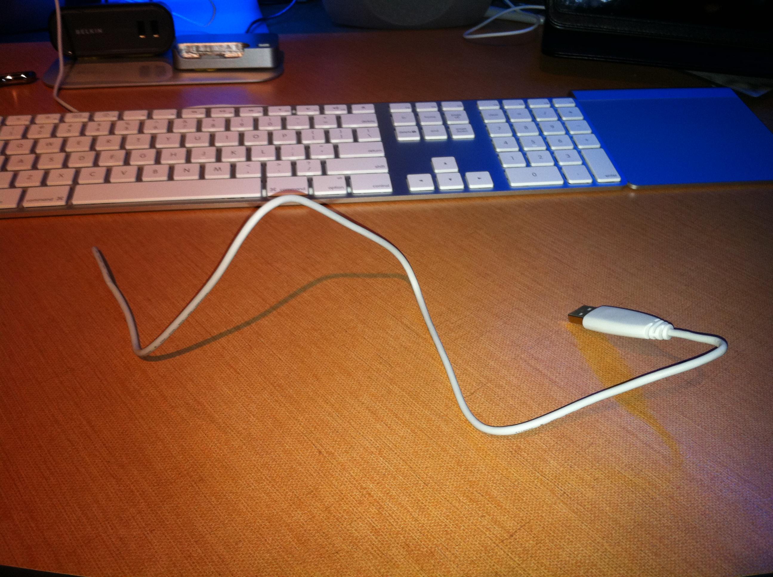

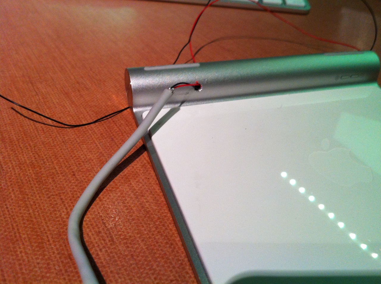

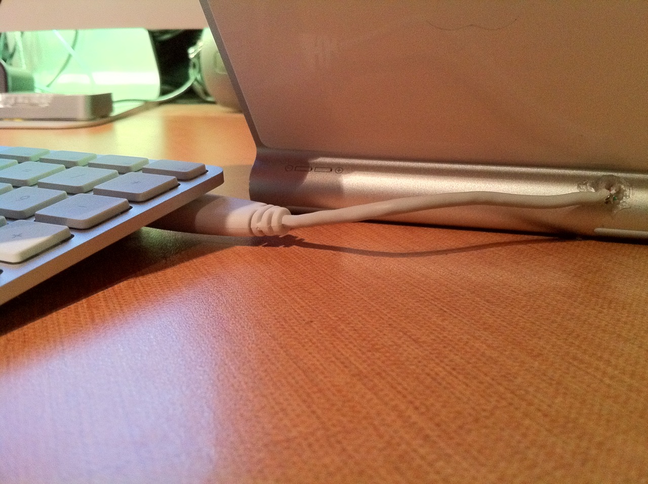

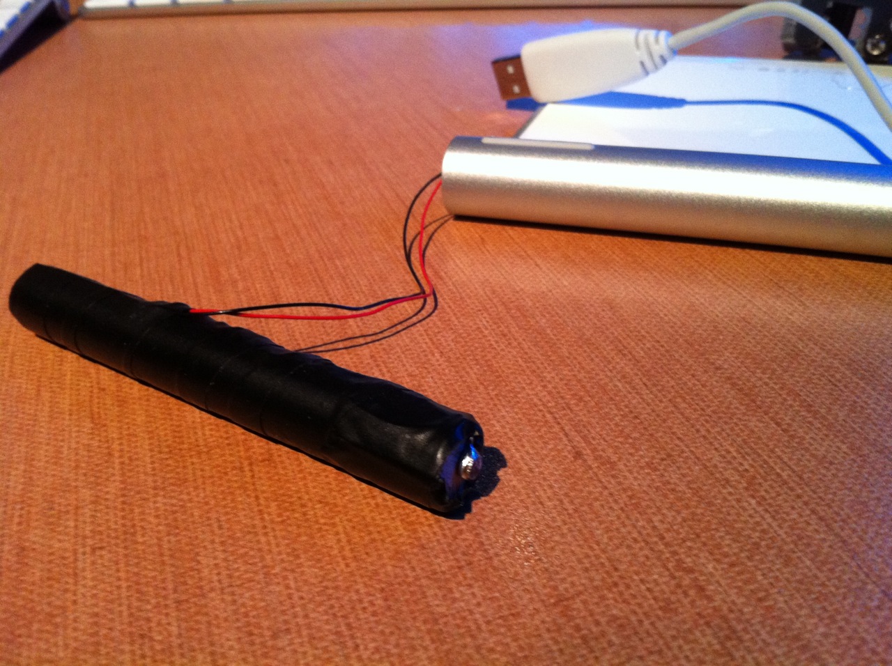

My attempt
Here's my attempt. I used four instead of three of the diodes and I will be taking one out soon as it's telling me to replace my batteries. I hate drilling into the thing but it looks better hidden.
Thanks to the original poster for the idea.

No. The mod only allows the Magic Trackpad to draw power from a USB port. It still connects to the computer via Bluetooth. You'll still need a newer OS for it to work.

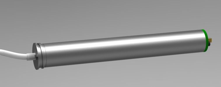

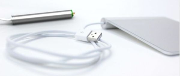

USB power adapter for Trackpad
A friend and I designed an adapter that goes into the USB. We tried Kickstarter for funding, unfortunately they rejected it saying the project is "not right fit" for them. So instead we put it on Indiegogo:
USB Power adapter project on IndieGoGo
Here is the design that we have:
and here is how it will look like:
Check out the video on the IndieGoGo page to see the prototype.

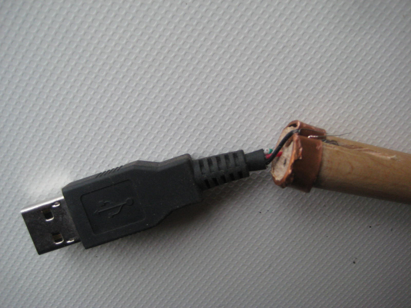

Brilliant idea!
Works perfectly fine for me with a short cable plugged into the right side of the keyboard.
I noticed though that the black cable has to be wired to the threaded part of the casing, where the cap closes it. On any other part of the tube it did not work.
I put a copper rim around a 12mm wooden peg and connected the black cable to that. The copper rim fits neatly into the tube of the trackpad. A small hole in the top to put the red wire wire trough tidies up the whole affair. The red wire is connected to a copper screw at the top end of the peg.
Thanks a lot for this post.
