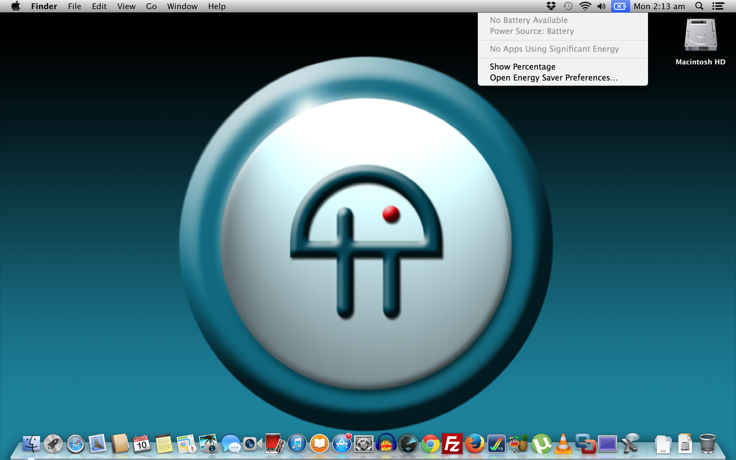

This is more than one time i've had this issue. I get a "No battery available" on my MBP-R, even when running on battery.
Sometimes i need to power off and do SMC reset, while other times the icon changes to a battery icon without a "X" and reports stats is correct.
Is this normal ? or should i get is checked out at an Apple Store?

First, make sure it is NOT a hardware issue.
Although this won't totally preclude the possibility that it is a software issue, do this:
You can diagnose this by going into System Preferences, and create another Fresh New User Account (with admin privileges). Then, log yourself out, and log yourself back in as the brand new user you just created.
Fiddle around as the new user for a while, and see if you have the same "no battery" symptoms.
If the symptoms completely and permanently go away, then you have something messed up in your software, and would want to do a reinstall of your Operating System.
Otherwise, if it is a hardware issue, then do all the hardware resets available to you (zap PRAM, zap NVram, or whatever can be zapped these days). And, if the battery is self-serviceable, then replace the battery w/ brand spankin new one.

I would certainly have it checked by Apple.
PRAM/NVRAM (PRAM on non-Intel-based Macs, NVRAM on Intel-based Macs) has nothing to do with battery/power/charging issues, so resetting it will not help. Only SMC affects such issues.
