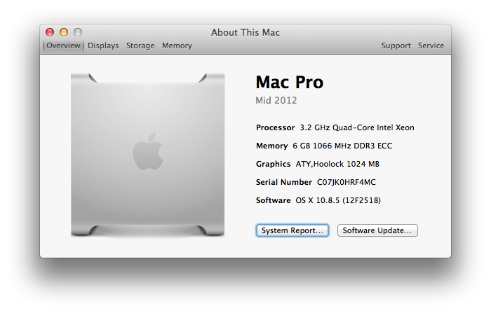

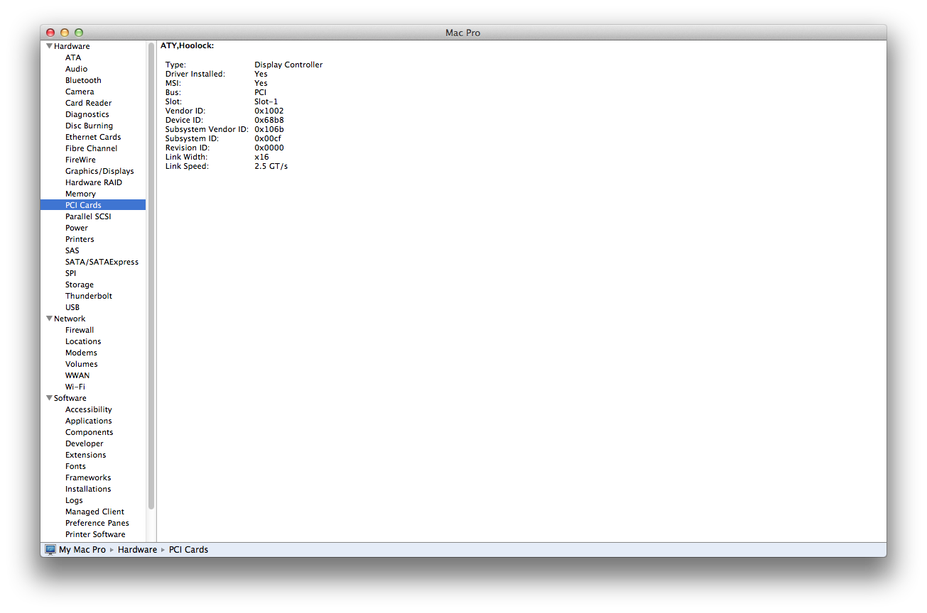

Here's a screenshot of the system info when the boot screen isn't showing.
Please help!!

I am running 10.8.5. No, I haven't tried a reinstall. Would you recommend a fresh install? I have posted the screenshot to show that the card isn't being properly recognised. Here are a few more. I didn't think of a reinstall cause i though it would be related to the logic board or card's EFI.
Thanks.

I wonder if it is normal for an Apple version of a 5770 to have a garbled description in System Info. Wouldn't it normally read something "clean" such as ATI Radeon 5770 1024MB." It may be the card isn't recognized properly.
Would an older card such as this have had dual EFI? Maybe the switch between Mac and non-Mac EFI is getting bumped or shorting out. Would explain lack of boot screen. If the card isn't dual EFI then this theory would be pure BS of course.

I am not sure here, from your screenshot showing the 5770GPU profile, does not look like a OEM Mac version. I know you mentioned it is an OEM Apple version, it may be a PC 5770 unless I am mistaken. If I understand, you mentiioned in your first post, machine boots into your desktop without showing the Apple bootscreen.

You should have 5 GT/s link speed. The card isn't recognized properly.

Intermittently, in the last few days it did show the boot screen and the link speed was 5 then. It was 5 before the trouble started too. As I mentioned, it has been working fine for the past two years.
