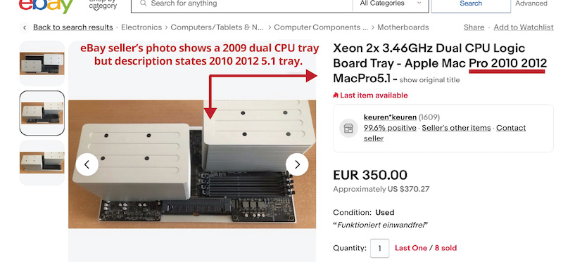

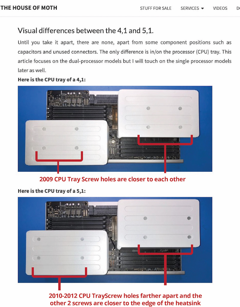

The photo of the dual cpu tray above looks like a 2010-2012 dual CPU tray instead of a 2009, 4,1 Mac Pro. But I hope you have the correct CPU tray for your 2009 Mac Pro. The four screw holes on the heatsink are closer to each other in a 2009 dual CPU tray. With a 2010-2012 dual CPU tray, the screw holes are farther apart.

If that is true... Then I have to replace the backplane instead of sending this back to the other side of the world.

It's a hassle when sellers sells you the wrong tray for your Mac Pro. And some listed dual trays don't show the actual photo of the tray. I've just purchased a 2010-2012 dual tray and had to verify and communicate with the seller if the dual tray he is selling is a genuine 2010-2012 dual tray, if his photos are the actual item and if he has tested all the 8 ram slots. Got the correct dual tray. Hope your Mac Pro will be up and running. If I recall correctly, tsialex mentioned that aside from the fans revving up, the logic board won't be able to read the processor tray correctly due to the different SMC firmware.

Thank you. I purchased from a very big seller. But it may be a wrong dual cpu board. We will see. I want two Mac Pro's in a while. I do not have an direct need for this computer right now. If I receive a 5.1 dual cpu tray... I will go and look for a backplane or a single cpu 5.1 Mac pro.

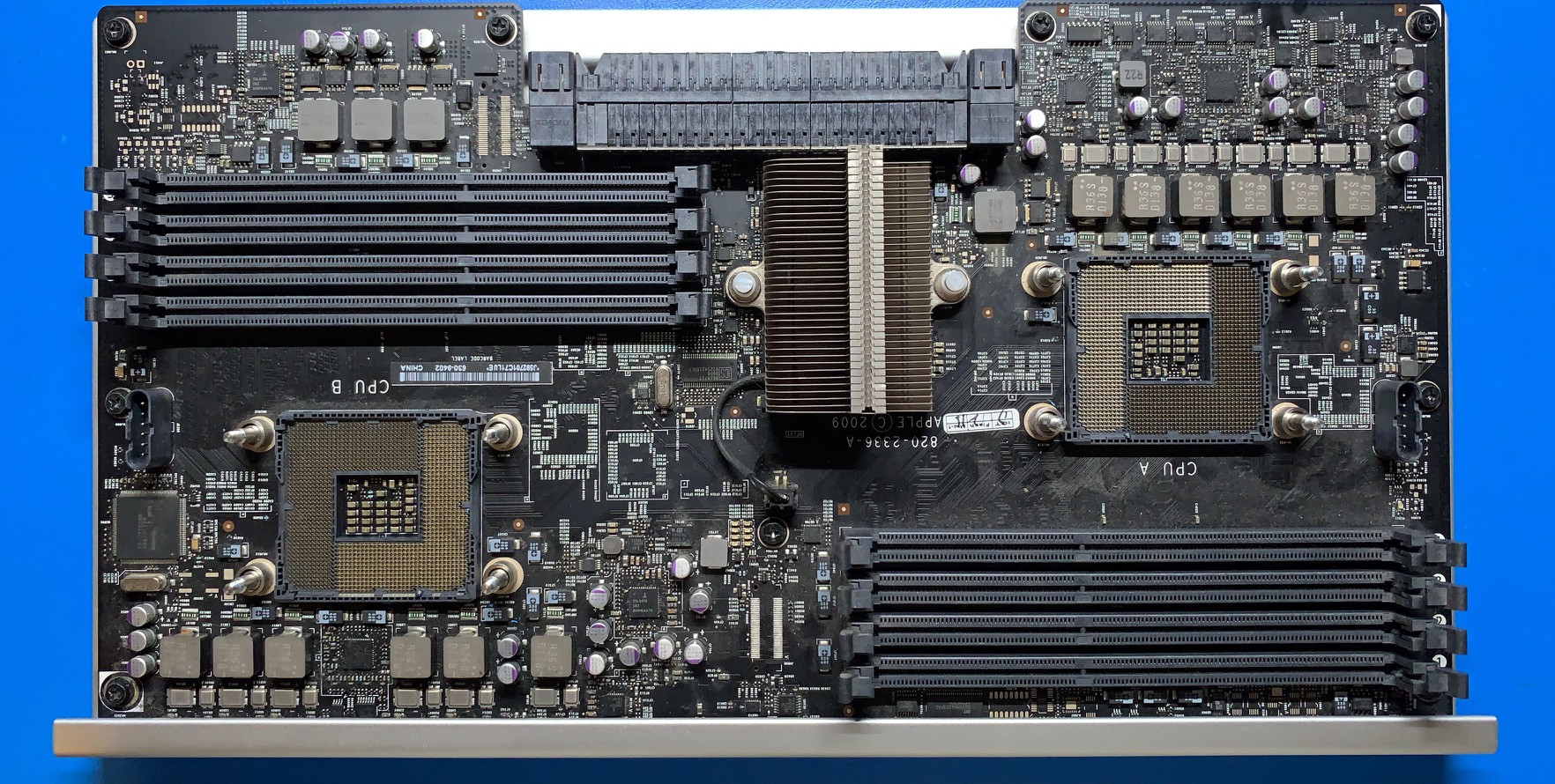

On the board I sent out the hardware guy said the northbridge is toast. I have yet to find someone who repairs those and to find what actual chip (s) make the northbridge on the Mac Pro 4.1 /5.1 .
You will pay way more for a repair than another board.
