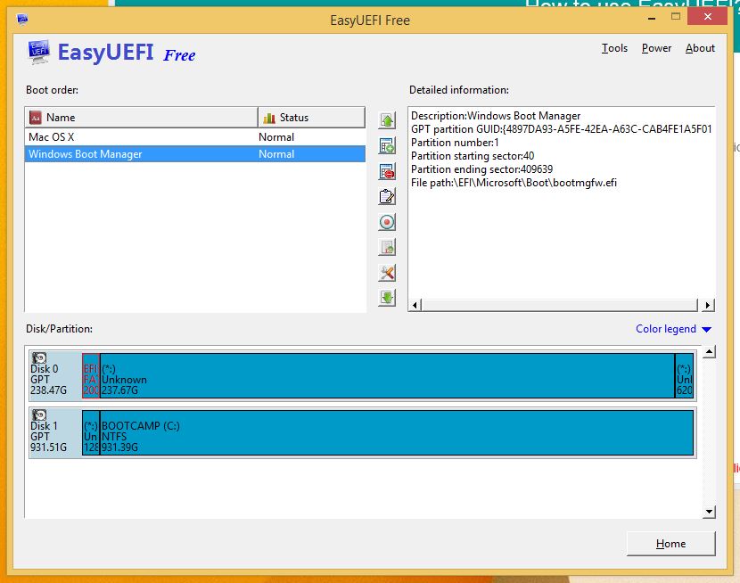

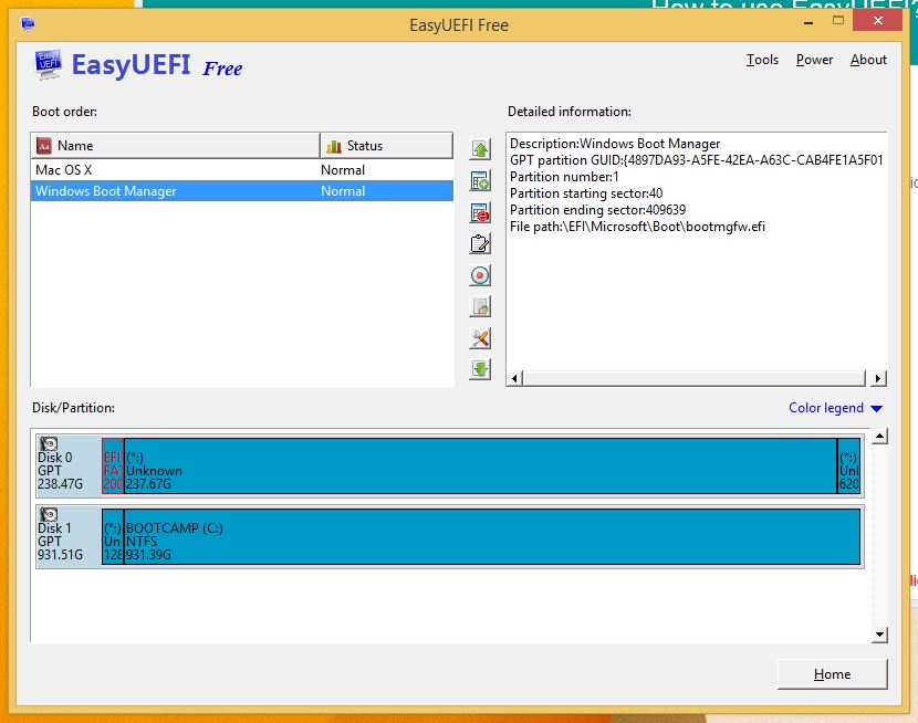

You can verify the problem (or verify its not the problem) by installing EasyUEFI in Windows and looking at the list of entries.

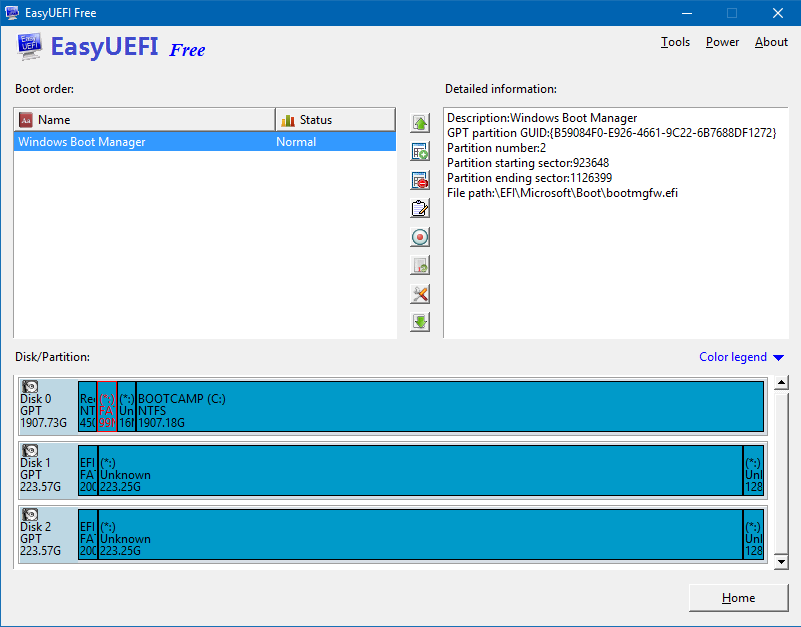

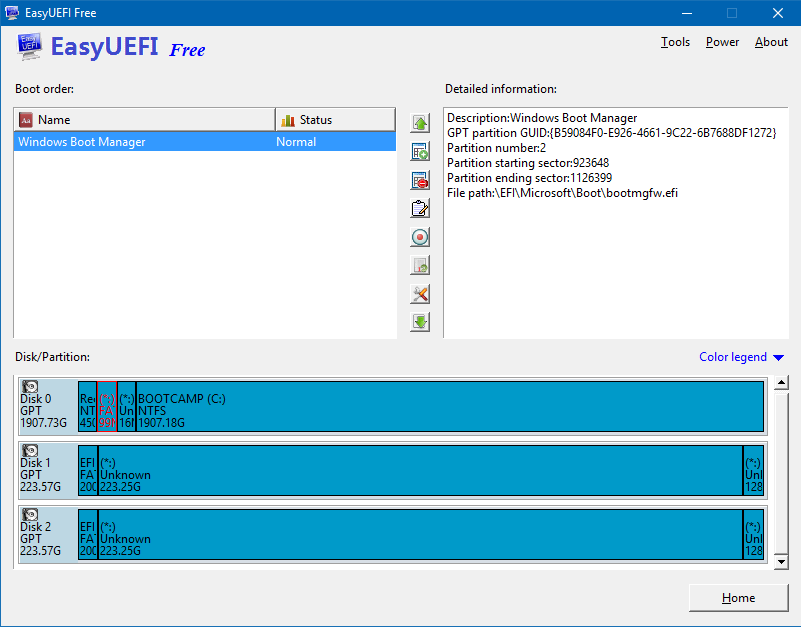

[doublepost=1476216261][/doublepost]Attached a screenshot from easyUEFI software.
What do you think?

Wow so far yours looks great. Mine was all messed up with duplicate entries, missing entries, and entries pointing to nowhere. I deleted all of them and just made two new entries--one to rEFInd and one to Windows, with rEFInd as the default.
But now I have no confidence that my solutions are your solutions. Can you click on the Mac OS X entry and do a screen shot again? I'm curious where it is pointing.
If you want to try the bless method again, I think I had the syntax wrong. This page has waaaay better information specific to the Mac:

EDIT: I just now noticed that your Windows drive doesn't have enough partitions for an EFI install (there's no EFI partition). So I'm guessing you reinstalled it as BIOS. Totally fine, I'm just noting that it's different since based on your first post you mentioned selecting EFI.
I'm using til now the ATI 4870 and hopefully once the solution found I'll be able to put back my Ti which is not flashed.
I'll do a screenshot of the macOS SSD.
I just reinstall El capitan on a fresh partition and guess what same problem 🙁
The bless command should it be that one?
sudo bless --folder "/Volumes/Backup/System/Library/CoreServices"
Screenshot coming soon.
I just realise that know I can't see anymore the EFI Boot where Windows 8 was installed from the select disk menu ALT. so funny - meaning I can't boot on Windows.
I don't know. It's hard to tell what's going on now. Your screen shot looks perfect to me. Our situations are far more different than I thought. rEFInd + cleaning things up in EasyUEFI worked for me, but we have different goals since I have boot screens.

Hey folks, bumping this thread. Ever since moving to Win 10 I lost my functionality for switching between OSX and Win 10. I used to use bootchamp in OSX and the boot camp control panel in Windows to switch back and forth on my unflashed TitanX and things were hunky dory on Win 7. After upgrading to Win 10 I had things working for a little while but was running into corruption issues on my Windows volume which precipitated a fresh install and the behavior has been off ever since. I do have a flashed GTX 780 for necessary moments, but the end goal is to have a stable system in place that will allow me to have just the Titan installed.
I run Windows 10 on its own SSD in an Apricorn Velocity 6G PCIE sled. My OSX 10.11 volume is on two SSDs in raid 0 on the backplane.
If the Win 10 SSD is installed, I cannot boot into OSX. The system will boot into Win 10 regardless of if I have OSX previously selected as the boot disk in the preference pane in 10.11. Once in Windows, if I use the bootcamp control panel and tell it to reboot into OSX, it simply reboots into Windows. So the only means of booting back into OSX is to physically remove the Apricorn sled with the Win10 SSD when I want to switch OS's. In that scenario OSX boots up no problem.
Now I was pretty positive I had installed EFI Windows 10 when I reinstalled, but in looking at the attached EasyUEFI screen shot it would seem it is not an EFI install. Does that seem to be an accurate assumption? Would anyone have any insight as to how to regain more control over switching between these two OSs? Thanks SO much as always!
