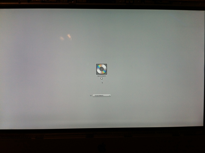

When I attempted to boot from ctrl, I did see the prompt to boot from CD.

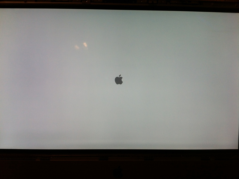

When I clicked on the CD, the Apple logo was displayed.... and remained with no result.
At first I questioned whether I properly seated the cable zif connector when I opened the machine but I don't think I would see a display at all if this was the case.
I could hear the CD turning but I just can't seem to understand why I can't boot from the CD to the new hard drive.

Either the drive itself is not connected all the way, it may be doa, or the cd is unreadable?
can you target boot the 4TB iMac to a working mac and see if you can partition the new 4tb drive?
you may also try booting holding Command R and try internet recovery to initialize the drive in disk utility there.

Perhaps there's an issue with the install disc or the DVD drive? An install disc for a version of OS X that's older than came on the machine (or for a different model) may not work. A DVD drive can be a finicky thing (dust on the lens in particular, a scratched disc...). The problem you're having at the moment is not directly related to the HDD (outside of damage you may have done during the HDD replacement).
You describe your machine in the thread title as a 2010, but in the body of your post as a mid-2011. If it is either a mid-2010 or a mid-2011, once you get the thing up and running, consider updating the firmware so you can use Internet Recovery in the future: http://support.apple.com/en-us/HT202313 That way, you won't be at the mercy of the DVD drive or need an install disc at all.
For that matter, perhaps the firmware update was installed. In which case, try booting with Command + R.
