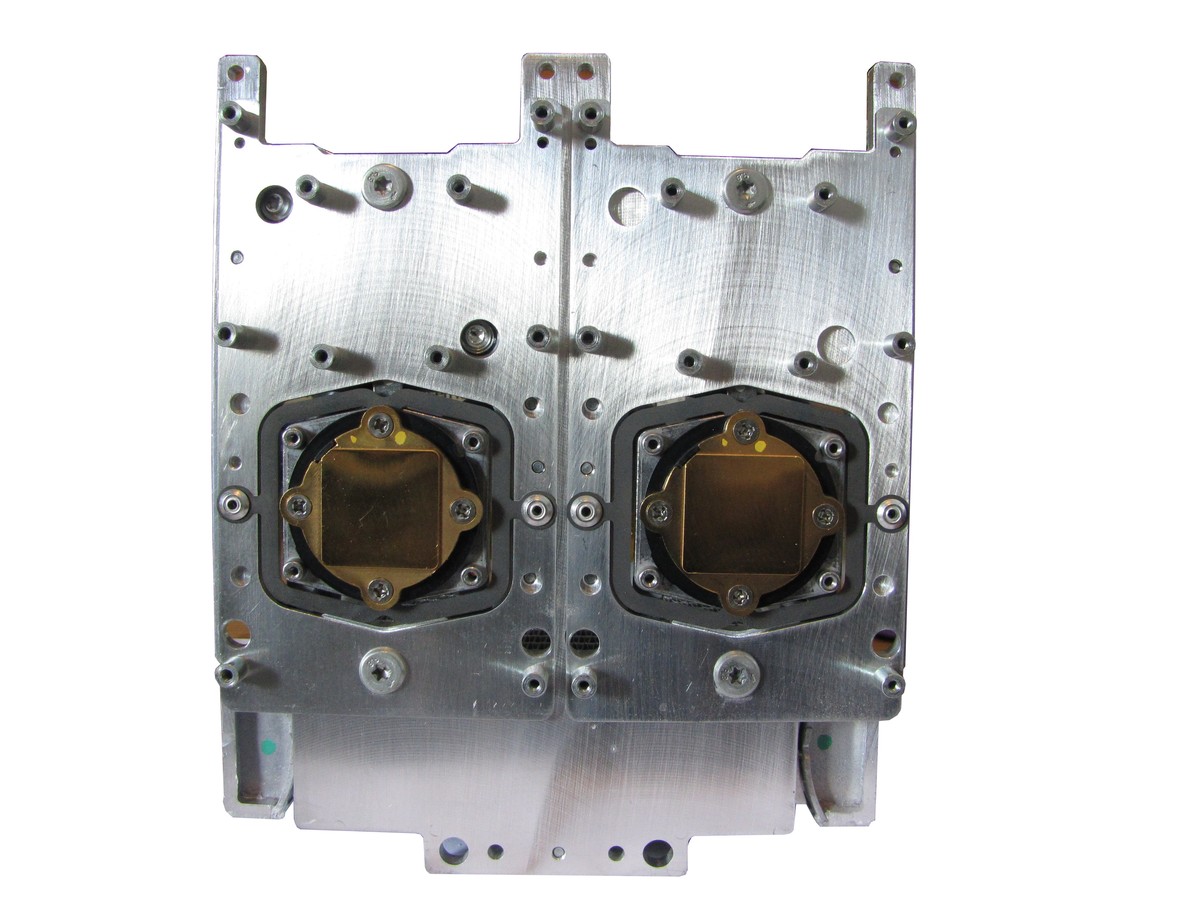

Remove LCS, next remove CPUs and look at waterblock gaskets. Leak could be very small as for now, but enough to destroy one of CPUs.
You will need to reapply thermal paste after that.
