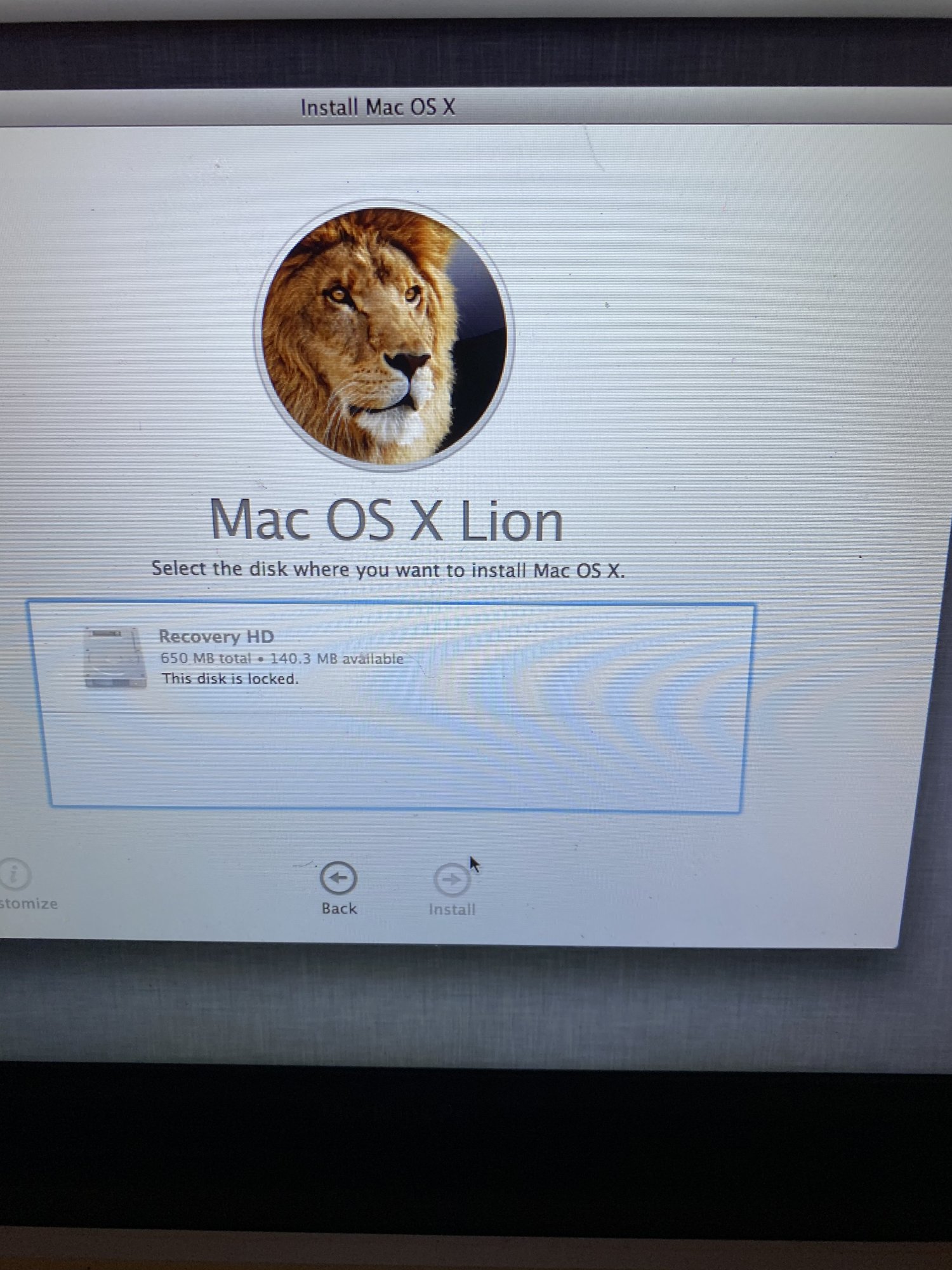

My MacBook won’t start up. First I tried recovery (control r) and the disk drive was locked so I could not reinstall Os lion. Then, per a suggestion of a user I tried internet recovery (control alt r) and now the disk is missing (as a destination) to reinstall. Thoughts?

This is the screen when I try control r start.
I believe that is the recovery partition... it's only 650MB. The other partitions aren't even visible. My guess is that your HD is dead, which would also cause your mb to not startup. (Sorry) How old is the machine? I hope you have been making backups. If you haven't been doing backups, then what I'd do is not muck with that disk anymore and risk really wiping it, put in a new HD (preferrably an SSD), install the os on the new disk, then hook the old disk up externally with a SATA-USB cable, and see if you can access any of your files.
