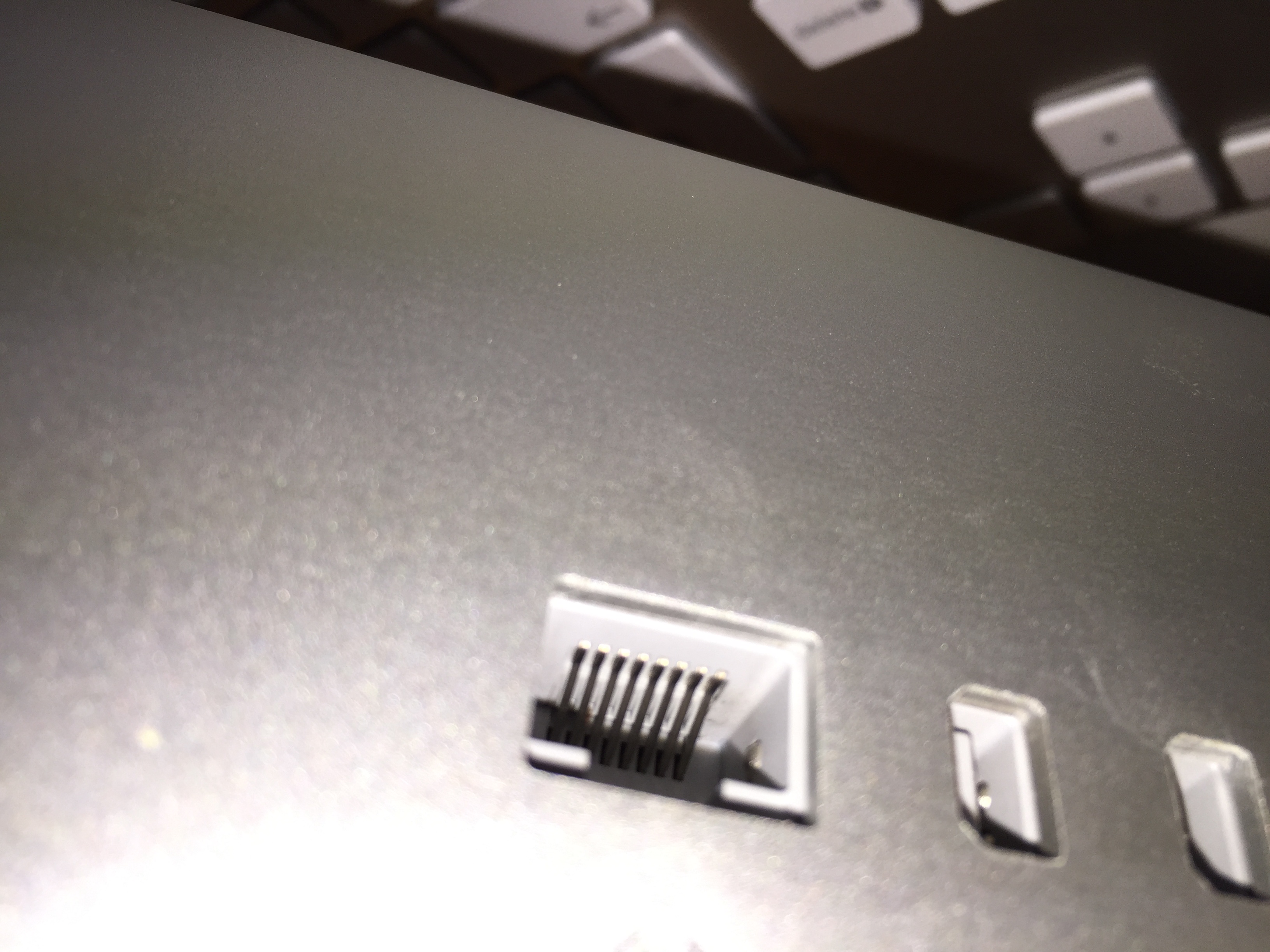

I have plugged my flatmate thunderbolt > Ethernet and that works ! get 1000mbps so it must be a port issue or driver issue on my iMac
THUNDERBOLD ADAPTOR:
I took picture of my port, doesn't look like any of the connectors are damaged:
