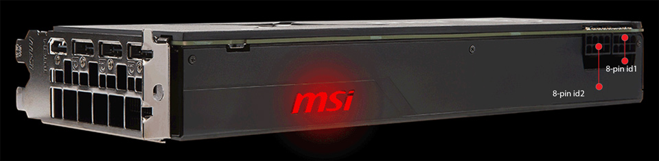

Hello,
Yesterday I did some test switching powers from 8-pin id1, id2 and mixing the power coming from the ODD bay and the 2x6-pin powers BoostA and BoostB.
From what I saw if ht 8-pin id1 is powered by the DVD bay at cold boot the graphic card won't show up.
moving the power to the 8-pin id2 seems to solve the issue.
I've tried different way to supply the Vega 56 by mixing the powers and the results are strange (hardware monitor and Istat Menu).

We can see test 3 and 4 are close to the Vega 56 TDP but the test 1 and 2 we are very phare !
Each time I ran a LuxMark bench to stress the card and each time the score were identical ~26900 at 1% ~ 2% differences.

Unless you are using controlled lab power supplies to power and monitor your GPU you won't detect the power spikes, or the initial startup/burst consumption, with monitoring apps.
Since MP5,1 backplane don't offer a lot of headroom for modern GPUs, just eliminate it with a secondary power supply or with a Pixla's mod.
And the Vega / any new GPU as you are saying are playing a lot more with the power than before (overclocking boost method).
I've completed my tests this evening and looks like the best configuration with a good power mix is with my setup test 4.
I'll see if the screen / GPU are loaded at cold boot tomorrow.
I reiterate my finding, test 1 and 2 are weird, low power consumption vs what the GPU should eat while doing a stress test (regardless the power spikes).
I've everything to do the Pixla's mod missing just some time to do it and the energy 😛.
