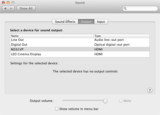

In systen preferences make sure you see this :
Then select the TV as the sound output.
Also make sure the TV has speakers and they are turned on.
That's the problem, i don't get the 'hdmi' option as an output.
