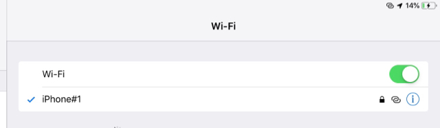

I just tried on my iPad. Can check my MacBook Pro later but don’t think it’s an issue.
