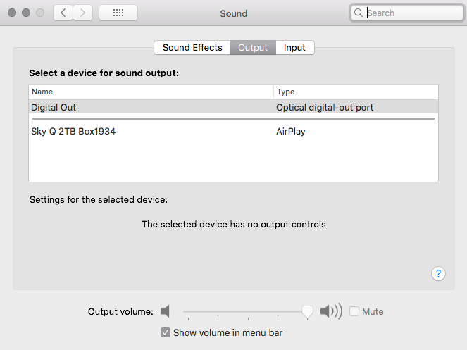

I have no sound. When I press the volume up and down buttons, I see this
- In sound preferences it says on digital Output an not internal speakers

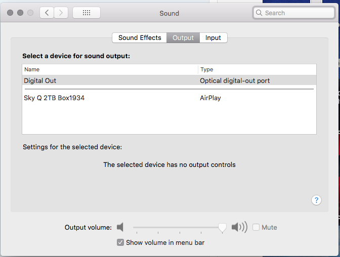

Headphones work fine
