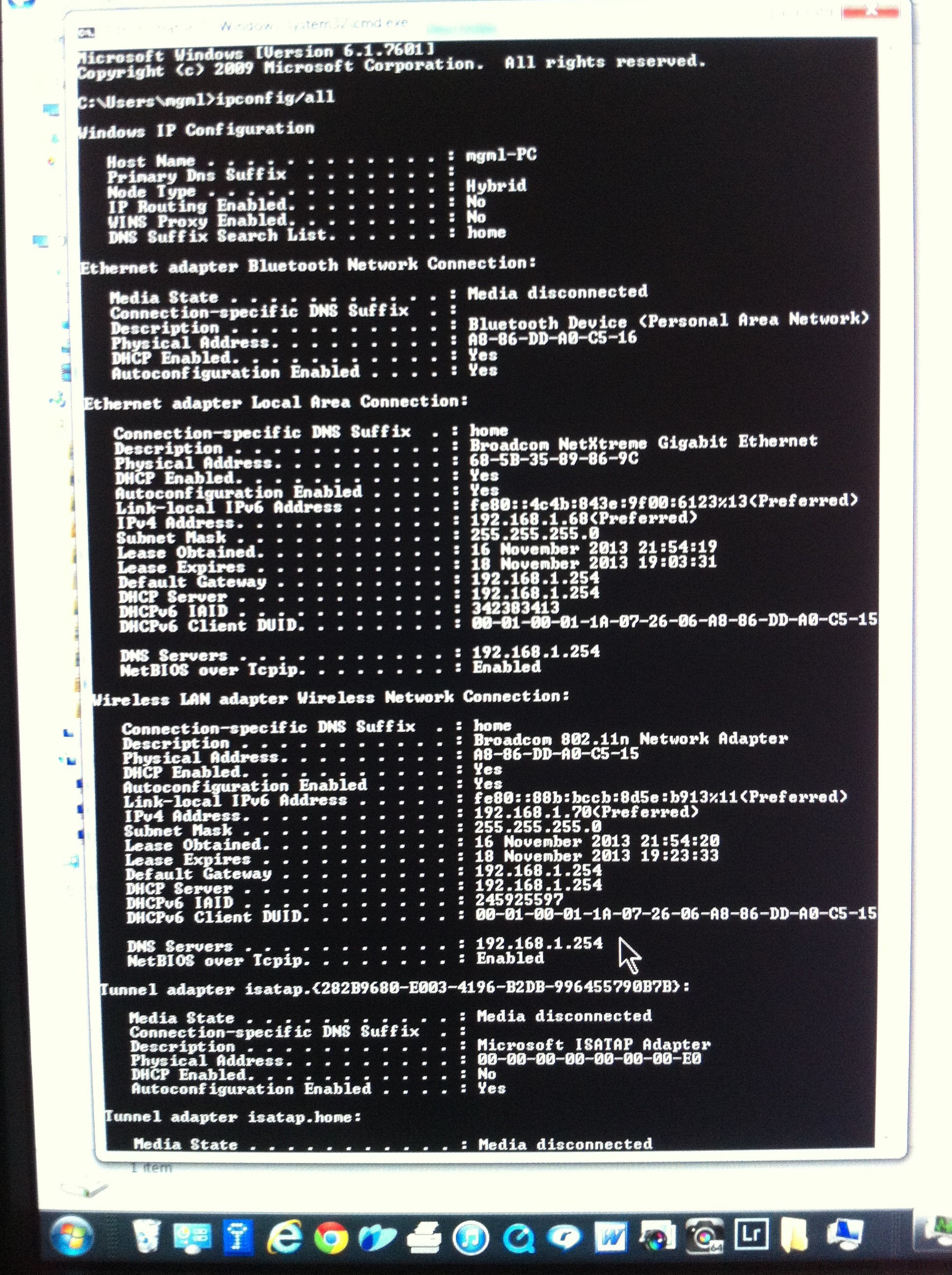

The IP address looks right, but do an "ipconfig /all" (without the quotes) to see if you have at least one DNS server.

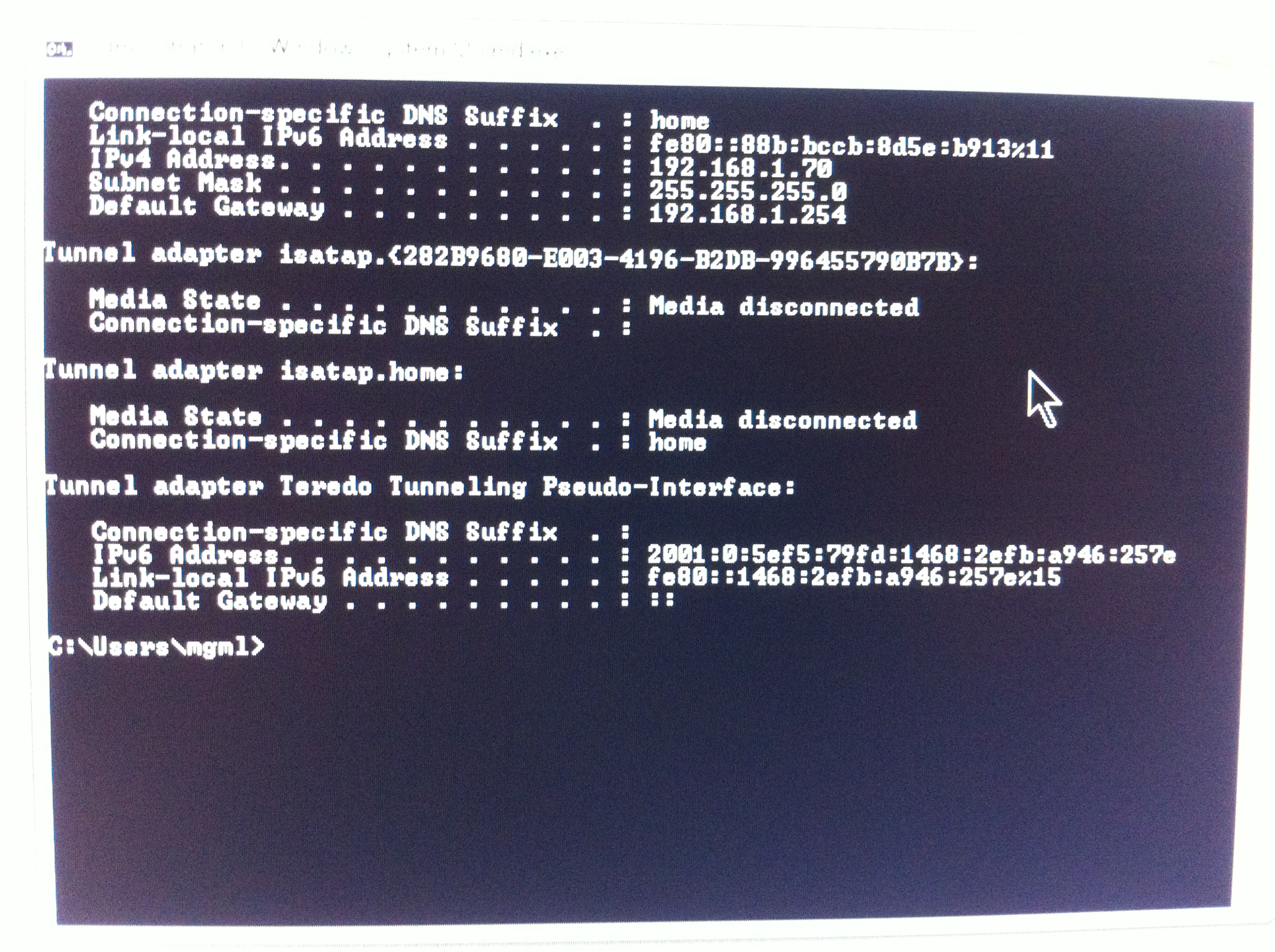

I did an 'ipconfig/all' and got back a whole bunch of stuff inc' 'DNS Servers'.....192.168.1.254.
Sorry about the crappy picture, I'd do a screenshot normally but am doing this from another computer.

The default DNS server is the router (192.168.1.254).
This can work if the router does redirect the requests to the actual DNS servers (as it is supposed to do).
