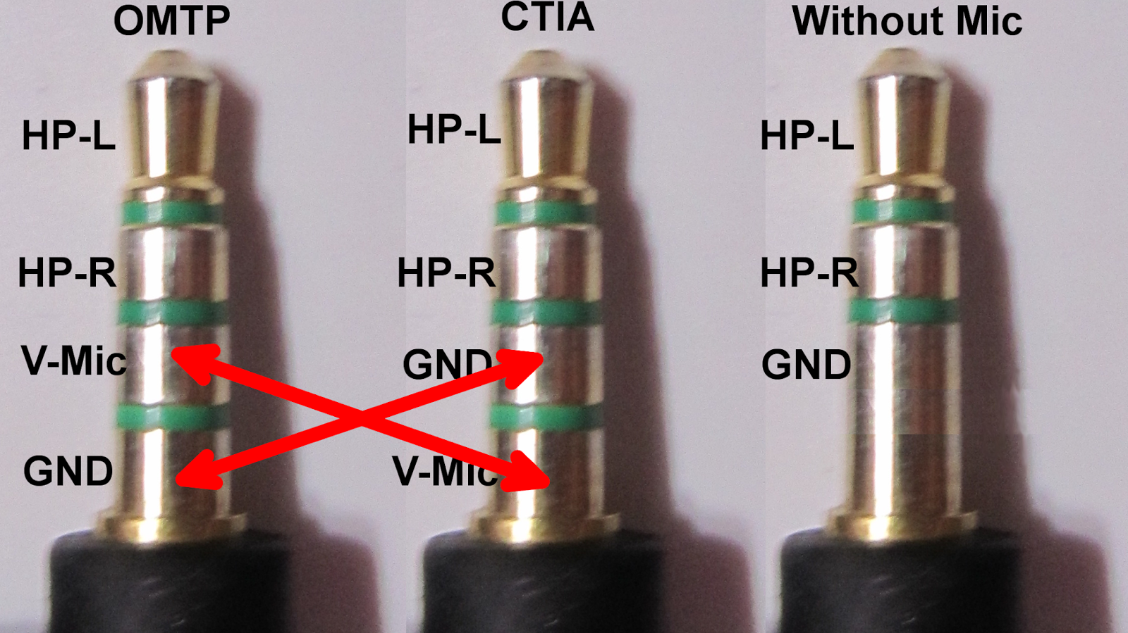

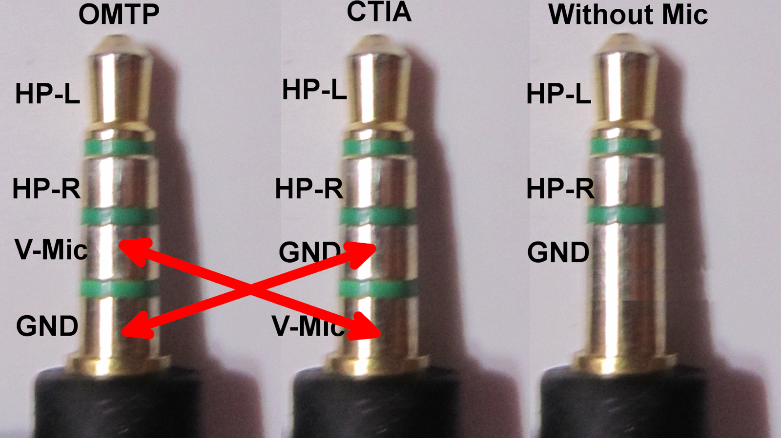

Also, FWIW, it does do a mic input, via a TRRS 3.5mm jack because that's what modern headphones with a mic do. So if you don't want to go for a proper interface, something like this will at least get you back to what you were used to. https://www.amazon.com/UGREEN-Headphone-Microphone-Compatible-Controller/dp/B07MR5TPKV
If you don't go with that splitter, make sure it says CTIA and not OMTP. There's 2 different pinouts of TRRS cables.
Tip is always left
Ring is always right
But the next Ring and Sleeve have 2 different options. One is always Mic and the other is Ground. Apple does Ground then Mic, but Nokia decided to do Mic then Ground.
Tip is always left
Thank you. This was helpful.
