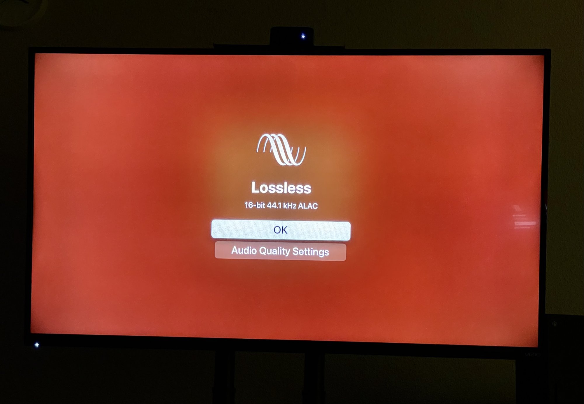

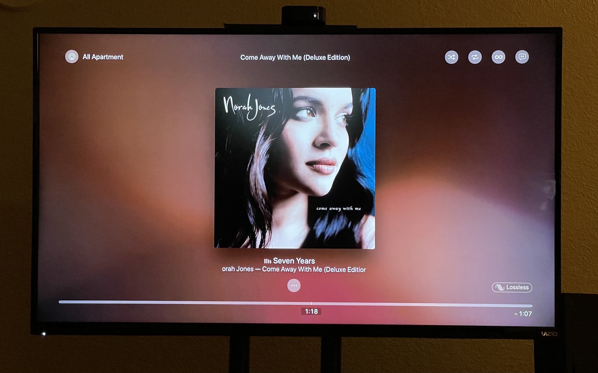

I was a bit disappointed to learn lossless@CD quality isn’t supported on Apple TV HD/4th gen.
It appears it is limited artificially and can be initiated if you start airplay from another app e.g. youtube, SoundCloud etc. And jump back into music.
Once setup the lossless stays and you can use your phone to control playback.
The TV seems to be grabbing the alac file directly on its own thereafter.
if you found this useful please report back. Goodluck!

I have that screen if I Airplay to my  TV but you still only get the maximum sound output that the  TV is limited to-24/48 on the 4K and 16/48 256 AAC on the HD. I have confirmed this on my receiver and the limitation is shown when you go to that audio quality settings menu. All the UI is doing on that screen is showing what the phone is getting.

how did you confirm that ATV HD is playing back AAC while displaying lossless in the UI?
I can’t update my mac to the latest Big Sur Otherwise would have been nice to confirm with xcode/dev tools.

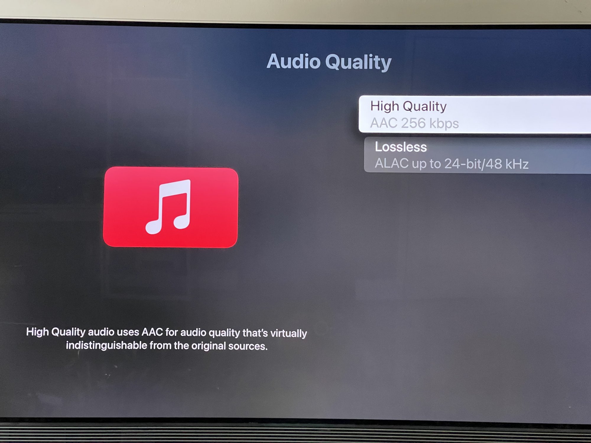

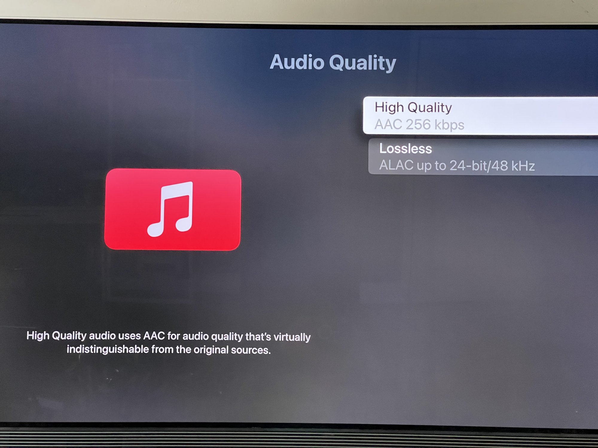

If you select audio quality settings in that menu, it shows “High Quality AAC 256”, and on my receiver I get stereo linear PCM 48khz and two channels play. On the 4K it adds the 24/48 option but I still get linear PCM 48k on the receiver, for Dolby tracks then I do get the Atmos on my receiver and all my channels play but still at 48k. My receiver is definitely capable of 192k an I can get that through my fire TV cube on Amazon Music HD. I agree with you that 16/44.1 would be plenty but all the  TV’s resample to 48k and always have and I’m not holding my breath that that is going to change. I’m on beta but I’ll reinstall the dev tools tonight and see what it says on there.
EDIT: I installed developer tools on my  TV but the HUD doesn’t show for the  Music app.

I don’t see the option of “High Quality AAC 256” on the TV settings(maybe we have different versions of TVOS)

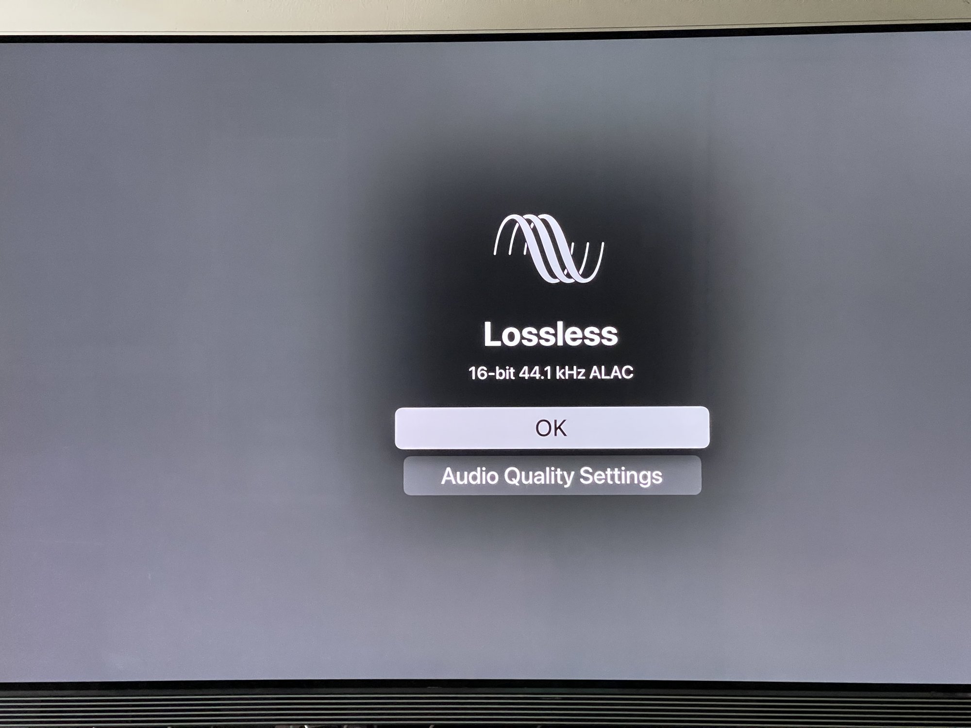

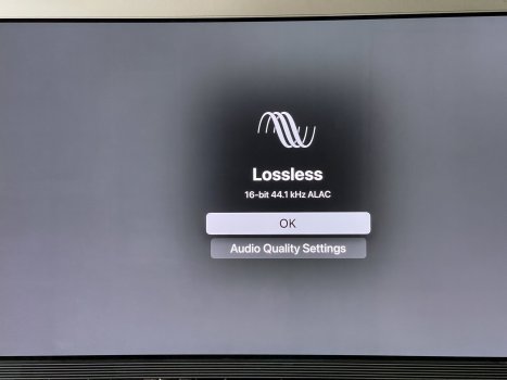

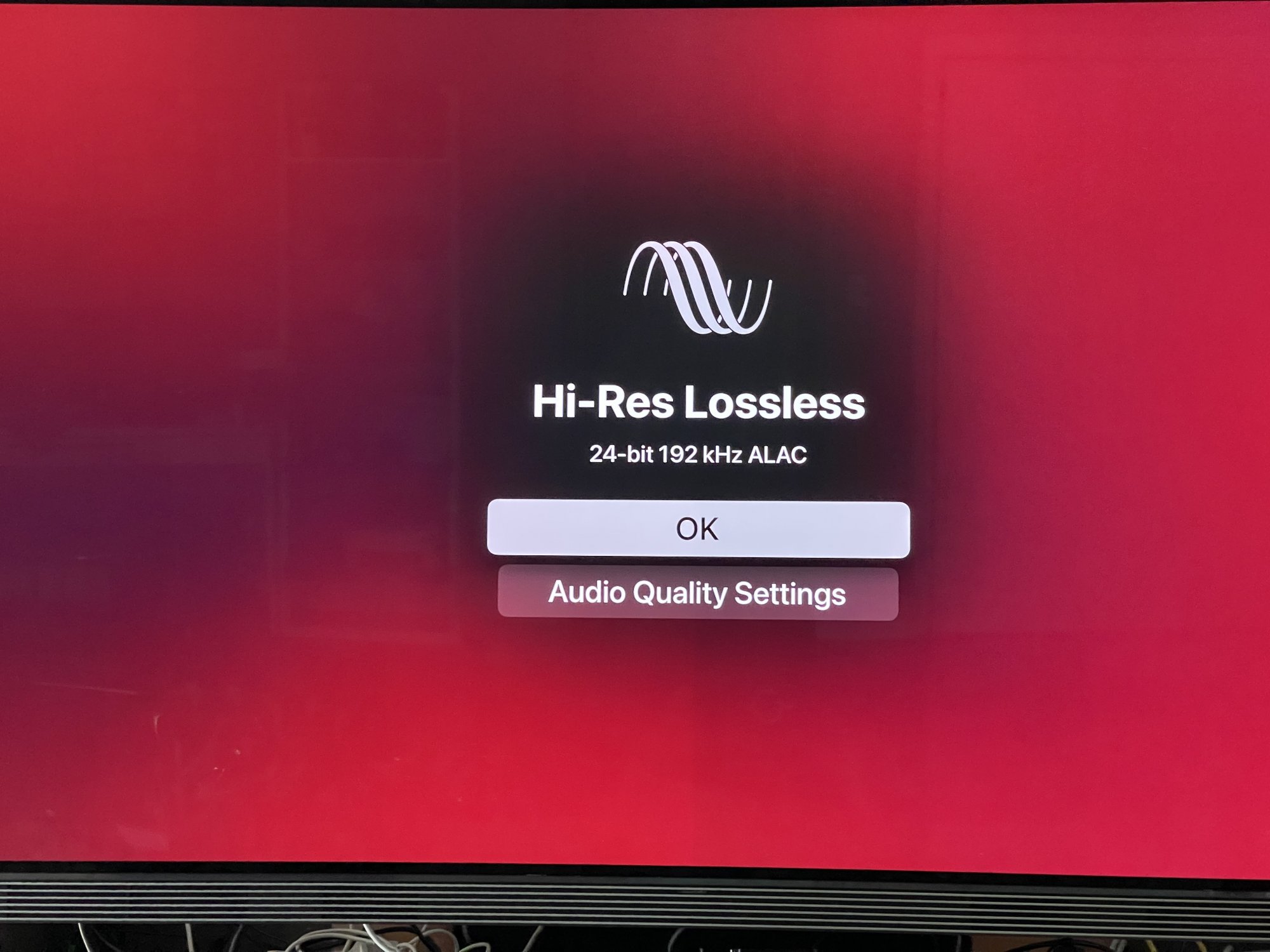

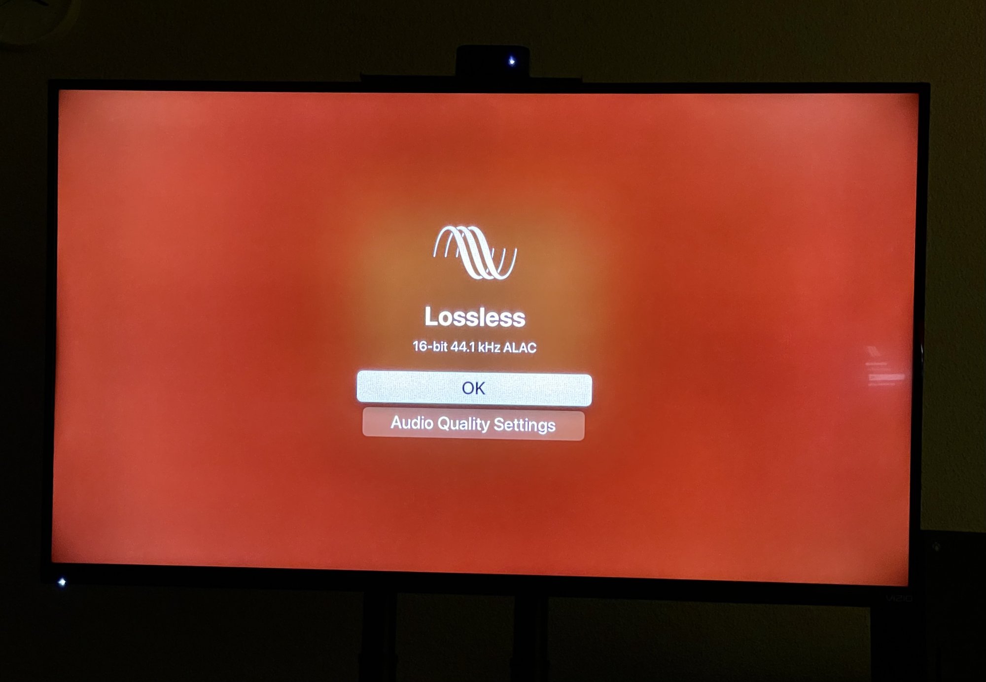

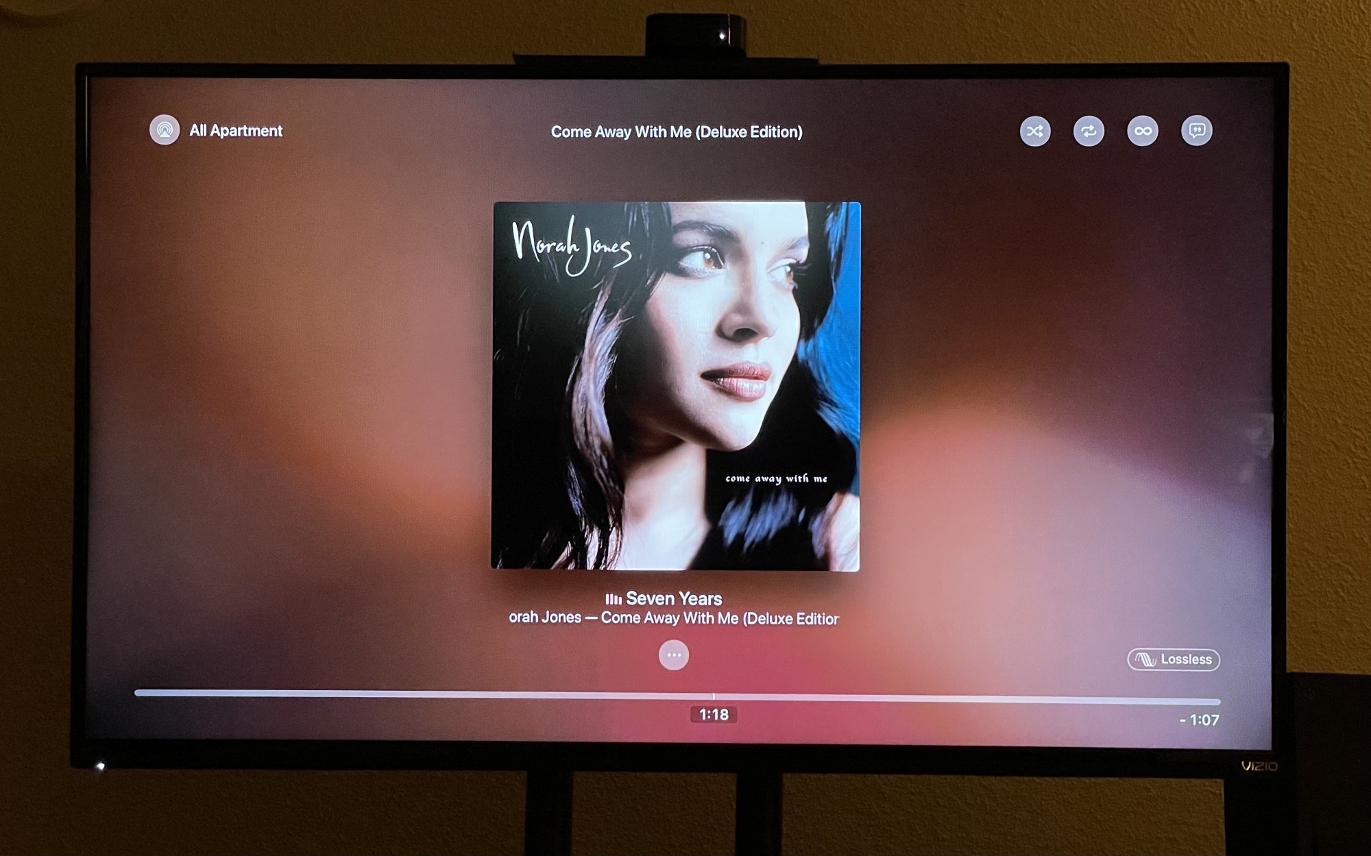

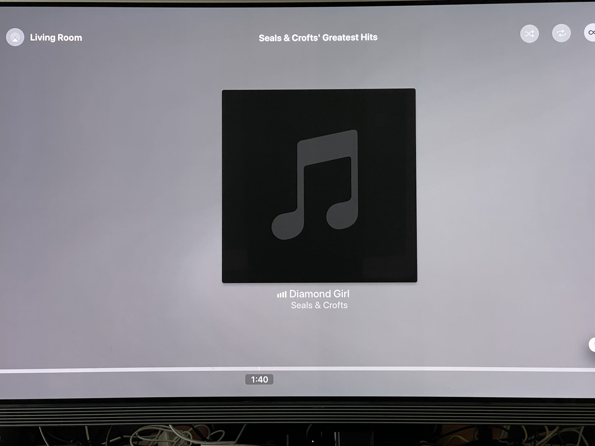

You’re right on the HD you don’t get that screen or option, I forgot which  TV I had hooked up but on the 4k you do get the option of 24/48 or AAC 256 even though the banner for lossless or hi res lossless comes up when you Airplay from an iPhone, all of them are showing 48k on my receiver however which tells me the  TV’s (both 4k and HD) are resampling to 48k no matter what.
  • Love
Reactions: VFX Artist and B/D

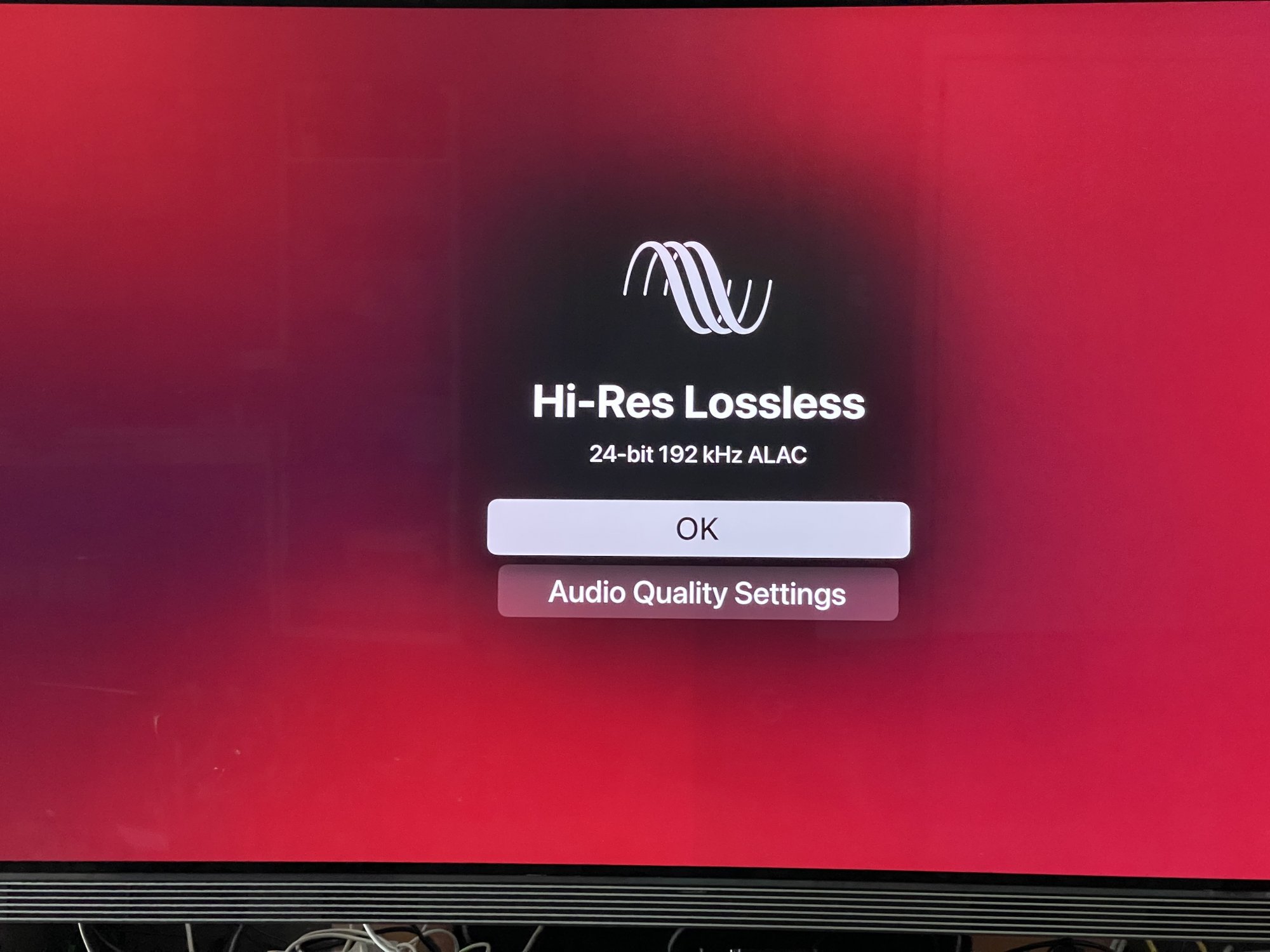

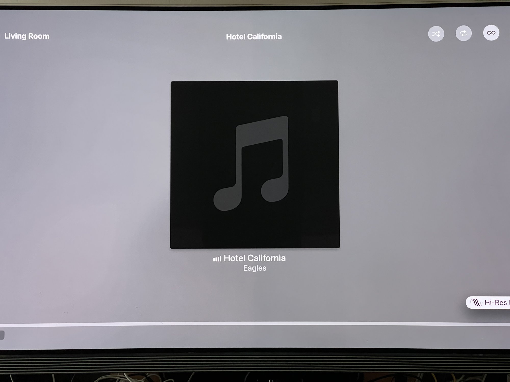

Doesn’t look like it. I have two ATV 4K’s (one of the older model and one of the new) and also an older ATV HD, I have updated all of them to the tvOS 15 beta, and I’m getting the option for 24/48 on the 4k’s but not the HD
But are you actually getting 24 bit output from the ATV4K, i.e. is whatever it's connected to actually receiving 24 bit. I have my ATV4K connected to my receiver which is capable up to 32bit/384kHz via HDMI, but even when playing a 24bit lossless track on the ATV, the receiver is only receiving 16bit. I hope it's a bug.

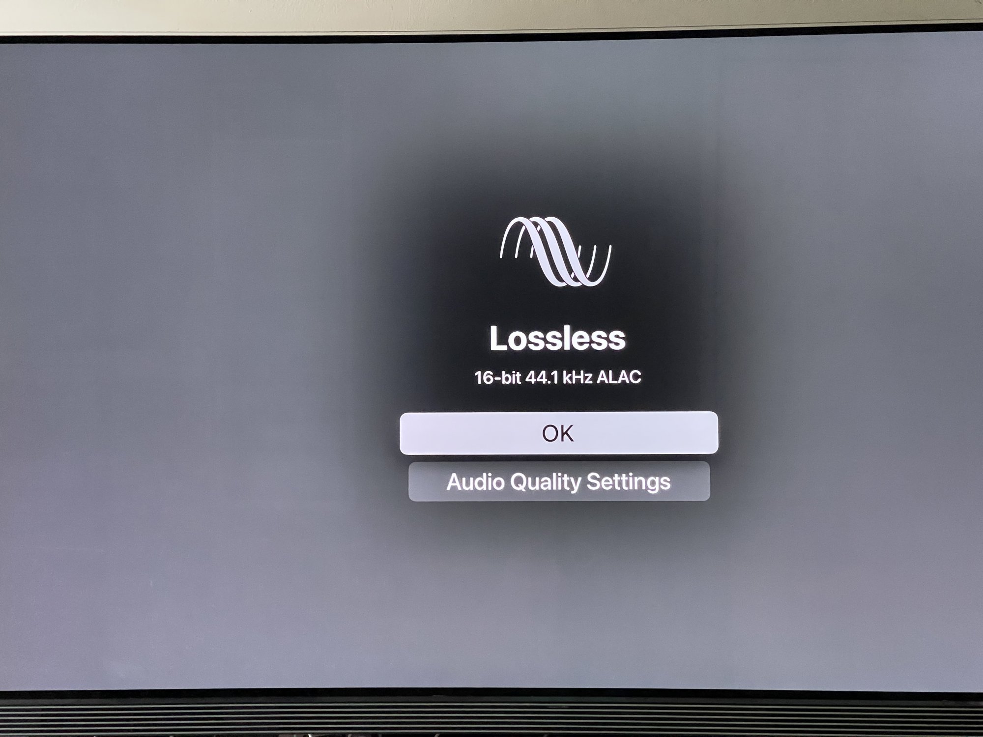

Navigate to and click the little lossless wave symbol on the bottom right of the screen (on ATV4K anyway) and it'll show you the track quality. If you're looking for a specific one to prove to yourself, the first track "Hello" in Adele 25 is 24/48.
Reactions: JasonHB
Just tried that on my AVR and it shows the sampling frequency as 48KHz, but doesn’t show the bit rate at all. It’s just got a dash where the bit rate should be, so something odd happening there
that I can’t confirm, my receiver shows 48kHz sampling which is what it shows for everything coming from the  TV, the HUD doesn’t come up for the music app, and I didn’t notice anything in Xcode’s log that shows me what it’s outputting
