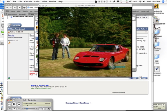

Heres a screenshot from the TopGear I recorded tonight on Discovery. 😀

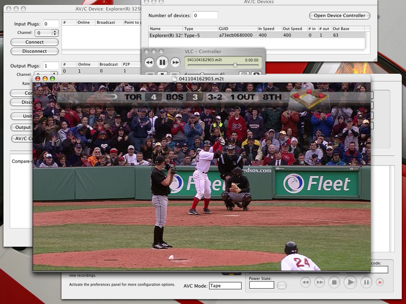

I used to have a Scientific Atlanta SA3250HD with a firewire port. I played around with AV/C, Virtual DVHS and VLC and was able to record and play back HDTV 😀 Since then I've upgraded to the SA8000HD which has a firewire port - but I don't think it's enabled...
Damn, I'm jealous. Hopefully when I get the MacMini setup and recording, it will be able to play HD, but I seriously doubt it. 😱
