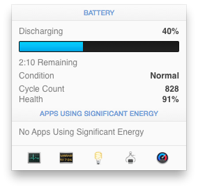

I see a lot of talk about keeping the battery healthy on MacBook Pro's. Here is my 2011 refurb with 828 cycles, iStat shows 91% health. I'll take that any day of the week. I leave my computer in the freezing car, in the summer heat, charge and take it off whenever I want, leave it dead for days, pretty much don't go out of my way at all.

Charging it all night has zero effect on battery health. Battery health will fluctuate up or down, regardless of when or how you charge it. You can charge Macs all night most nights and the battery health will not change. The two events are coincidental and are unrelated.
That's impressive. The original battery from my 2009 MBP dropped to 70% health around 400 cycles. I didn't baby it, but I also suspect that the MagSafe cable didn't help it. I had one of the t-shaped ones from the recall that I replaced about a year and a half ago.
