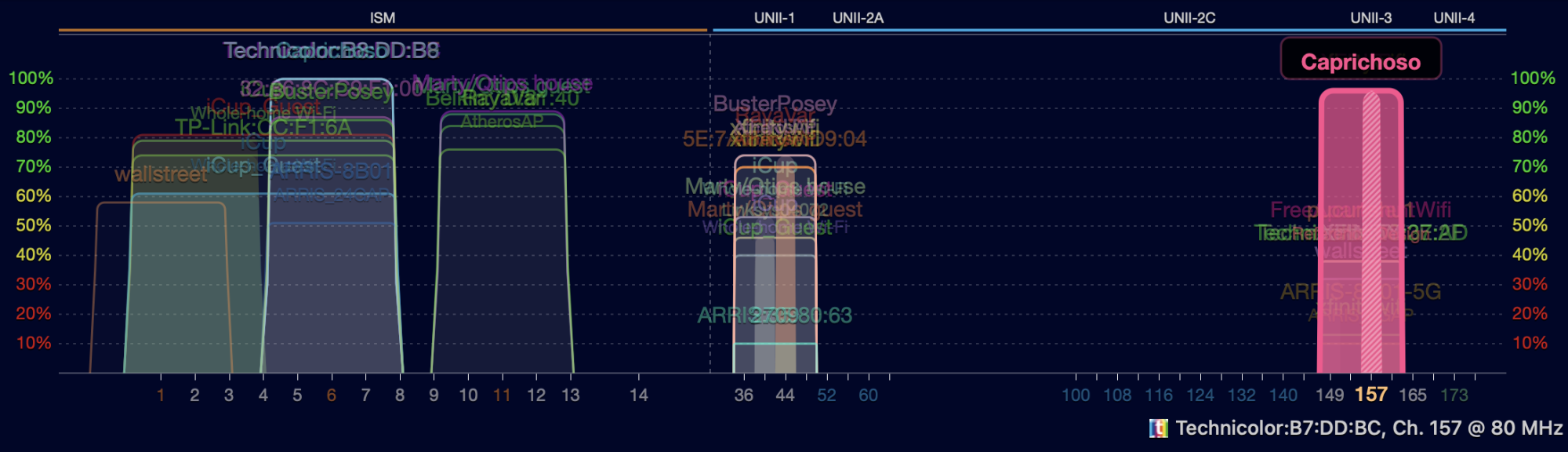

Are you connected to a "combo" SSID where the choice of 2.4, 5, or 6 Ghz is automatic, or do you have separate SSIDs for each frequency?
How congested is your network?

Remember, there is only so much wifi pie to go around (no matter how fast one's broadband tier speed from their broadband provider). OP has FIVE AppleTVs in his/her house. IF they are all on wifi, that's a LOT of video bandwidth demand potential if up to all 5 are sometimes in use. There's at least one MB, there's at least one phone, etc... all presumably taking a bite out of the very same pie. It would be little surprise to me that when wifi is in higher demand by so many wifi devices, some will report connection losses at times. That pie is not infinite.
OPs problem apparently resolved itself but should the problem pop up again, I'd take note of what else in the home is actively using wifi... maybe shut those down for an experiment and see if the problem persists or ceases. If it ceases, fire the other stuff back up and resume what they were doing and see if the problem pops again. Repeat. Repeat. And this will probably deduce the real cause.
If OP lives in an apartment with other wifi networks around them, is the problem seeming to show itself in more "prime time" periods when maybe neighbors are also using a lot of wifi? Any neighbors friends with whom OP has potentially shared a wifi password and now that neighbors devices are auto-connecting with his/her wifi vs. their own (eating ANOTHER bit of OPs wifi pie from OUTSIDEthe walls of their home)? If this is possible, change the password to lock out all external (possibly inadvertent) "freeloaders" and test again.
Now #6 is a DIFFERENT situation. Ethernet bandwidth is also not unlimited but much greater than the wifi pie. I'd still apply some of the same thinking above in terms of how much overall demand is on the home network when this problem appears. Document when it happens to see if "prime time" use for the neighborhood is when it mostly occurs... which could simply reflect heavy demand on the bigger neighborhood variation of the (much bigger) pie.
And of course, there are simply "blinks" in streams of bandwidth... which could simply reflect quality of signal, quality of service, local demands on service, distant server load, etc. A change of service or an upgrade of service may further reduce such blinks.
And then lastly, test the stuff you can test: different ethernet cable, different RG6 connection to the cable modem, check all connections from outside and within, etc. Reboot everything. Swap out any intermediary devices like a switch. Anything possibly overheating at times? Fan failed in some key device? Etc.
If I was OP, I would have run a bunch of tests with Christmas lights on and off, plugged in and unplugged to see if I could much more confidently confirm that there seemed to be direct link to that variable. But my own gut guess is dominated by too many wifi mouths to feed for the amount of wifi pie available in that house.
