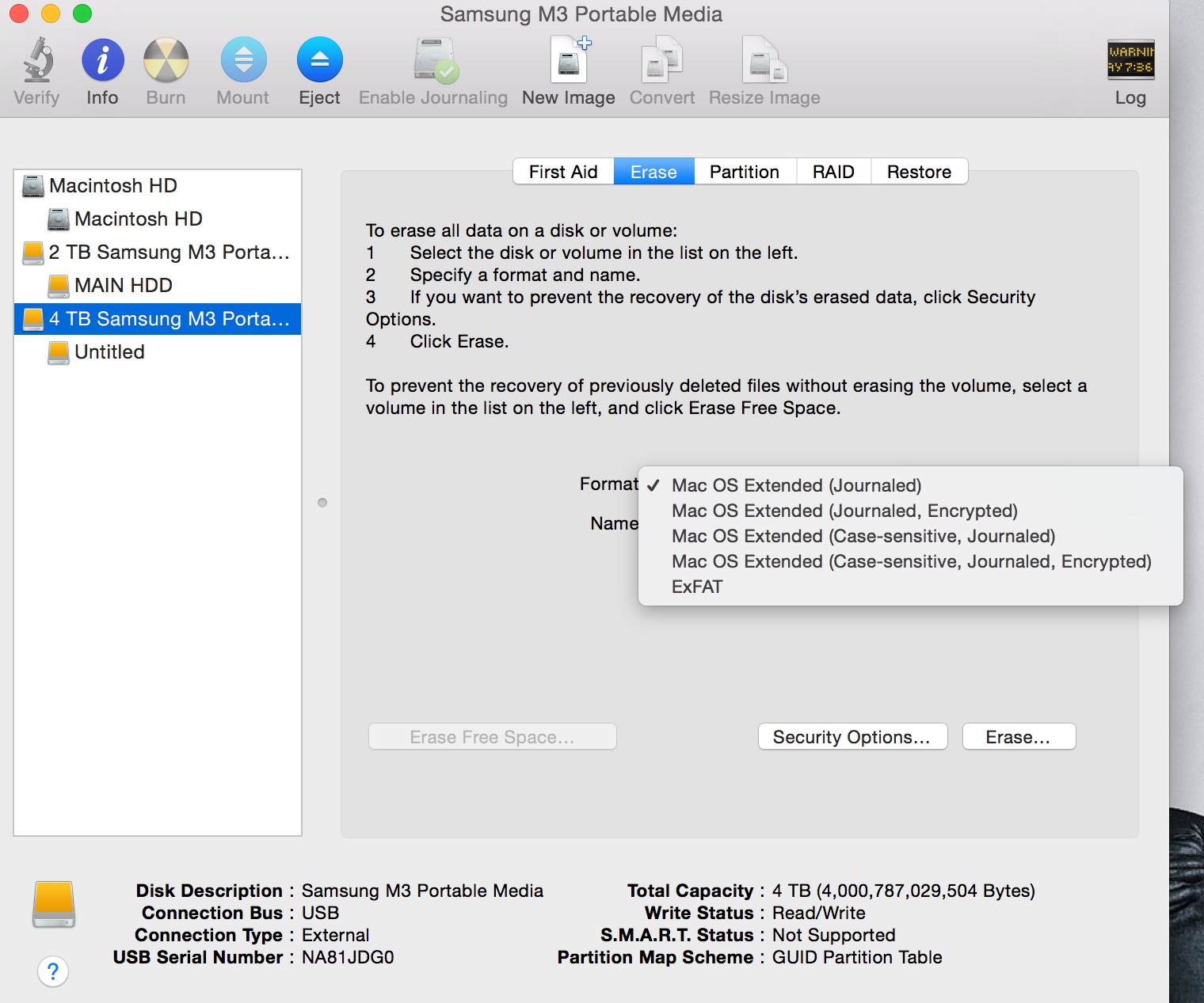

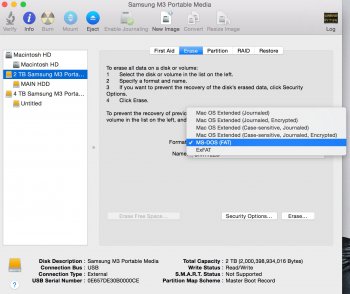

Hi there, I hope someone can help me. I've just bought a new hard drive today, it's a Samsung M3 4TB, I already own two 2TB versions of the M3 and I've never had any problems with either so far.
The problem is that I can't seem to format the 4TB version to MS-DOS (FAT), there's no option for some reason. I've tried all my other hard drives and flash drives and they all have the option. I'll upload a screenshot to show you what I mean. Does anyone know a way around this? Thanks

Hi,
also please note that the partition map scheme is GUID for your 4 TB drive, instead of MBR for your 2 TB.
According to this:
https://en.wikipedia.org/wiki/File_Allocation_Table#FAT32
the max size of a FAT32 partition is 2TB (max volume size) with 512B sectors. So to use your 4TB disk with FAT32, you'll probably have to partition it into at least 2 partitions, no more than 2TB each.
Thanks for the info, i created two partitions with 2TB each and I was able to format them with FAT32, unfortunately my PS3 still wouldn't recognise it.

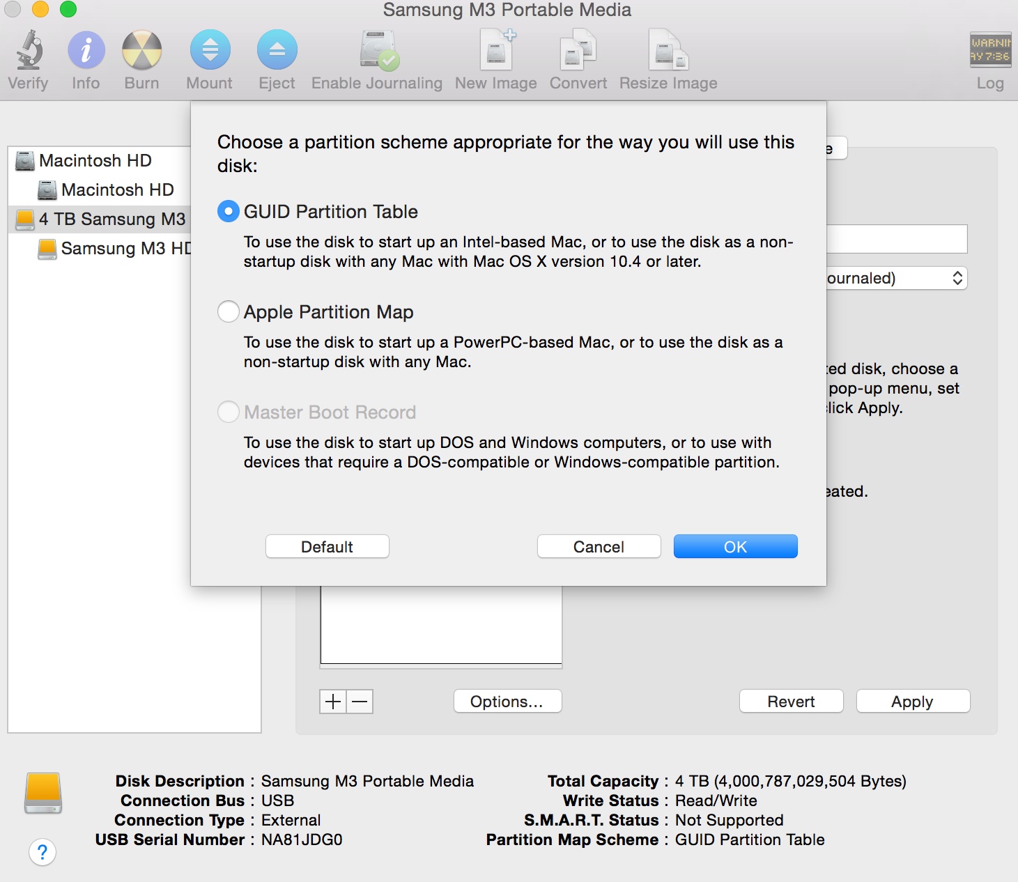

It won't let me use MBR, that option is greyed out.
Yep, sorry, you're entirely right. I refreshed my memory, and MBR can't address disks larger than 2 TB. Then I guess you're out of luck there. Find another use for your 4TB disk and get a smaller one for the PS3 (but google that use case before you put more money into it).
