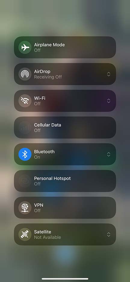

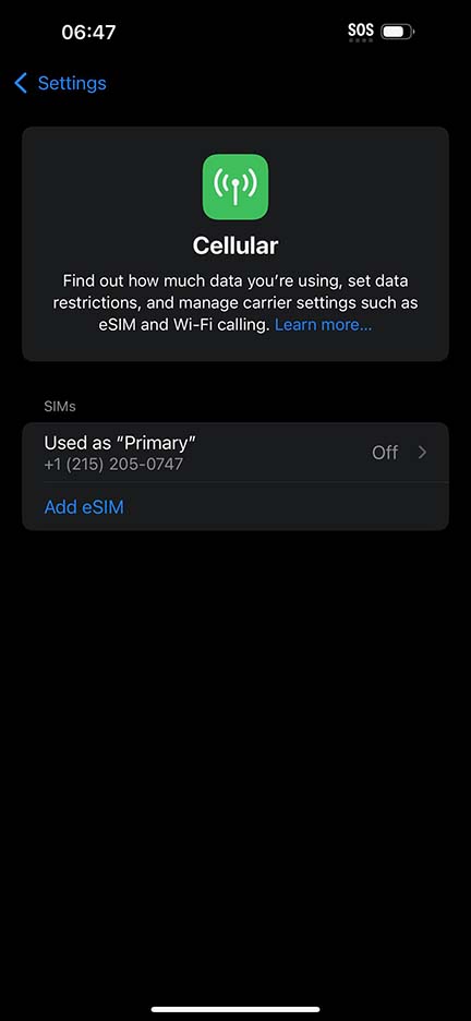

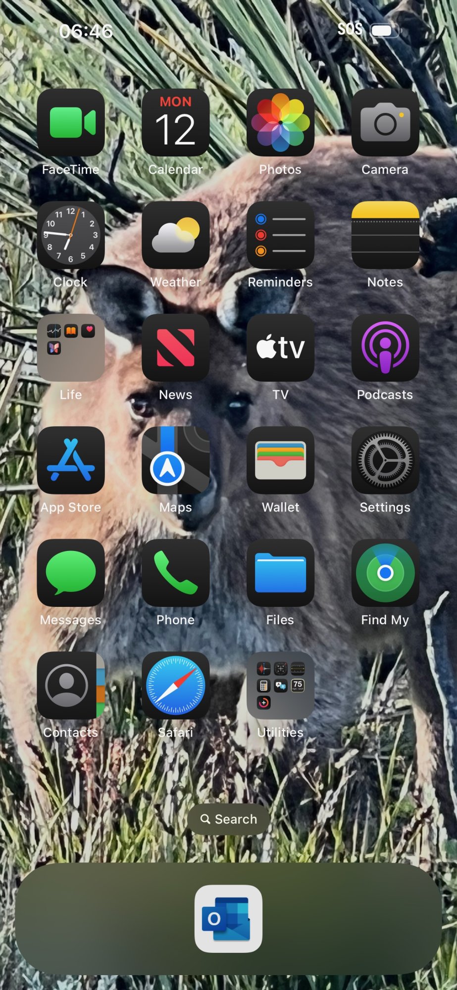

I upgraded a spare iPhone 15 Plus to iOS 18 Public Beta 3. I'm trying to test out the messaging over satellite, but I'm not being given the option to do such.
1. I've tried with both no active sim and an active sim that's temp disabled
2. wifi is turned off
3. I'm able to connect to satellites in the demo mode
4. The satellite option in the control center says unavailable, and I don't get the option to send via satellite when I open the messages app.
5. I don't get the satellite icon next to the battery icon in the upper right hand corner of the screen, only the SOS icon.
Also, Apple just told me that Satellite messages isn't available on the iPhone 15 plus. I know that's not true, is it?

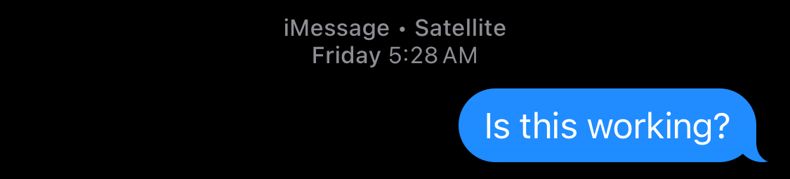

I recently tried sending messages using satellite on my 15 Pro Max with the 18.1 Beta 1 update while I was camping. It worked great! The satellite icon was right next to SOS, and it was super easy to use. If you wanted to send a text message through satellite, you could just tap the bottom of the screen it text messages to enable it. It did take a bit longer to send the message than I expected, but it was still pretty quick.

That's correct. Having the possibility of sending a text message via a "land carrier" (no matter the price) disables the option to send messages via satellite.
