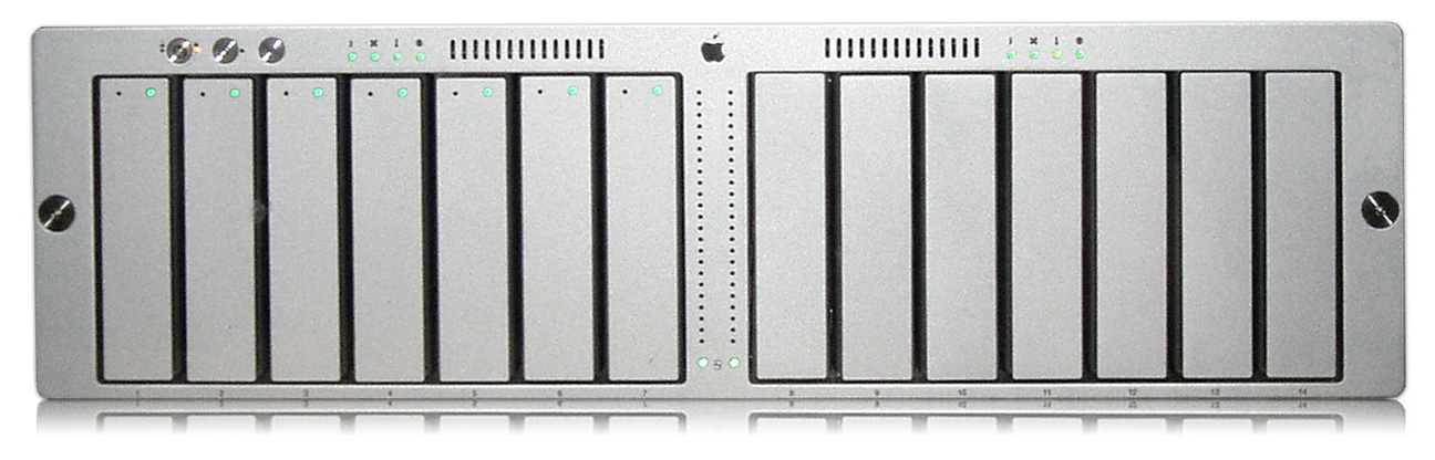

After a prolonged power outage (approximately 10 hours), my Xserve RAID no longer powers up. The indicator LEDs on both power supplies don't lite up in any way. I've confirmed that the power cables/outlets are working fine. The system was powered down when the power outage occurred.
I don't believe that both PS's went dead at the same time. Both cache battery modules are dead, but I don't think this will have anything do with the power supplies not showing any power status. Or could they? I'm thinking there's a problem with the logic board.
Although new cache modules appear to be plentiful on eBay, I don't want to arbitrarily replace parts in hopes of hunting down the problem.
I did pick up a cheap ($30), complete RAID chassis sans drives, but it's 2,000 miles away from the problematic system, and won't be brought over for at least three months.
Any suggestions until then?
If not, would I be able to transfer the intact RAID configuration to the new chassis by simply moving the drives over? I'm thinking not but hoping it will.

Well, I have a complete unit without drives so I can swap PS's from it, and other modules, to assist in troubleshooting.

I must clarify that I have the Xserve 14-bay RAID system, and not an Xserve Server computer.
I was hoping to avoid confusion between the two, but Apple's official nomenclature for the RAID chassis is "Xserve RAID", which can be easily mistaken for the "Xserve" server computer, which may also contain a RAID module.

I finally got ahold of an Apple Service Source manual for the Xserve RAID and from what I could ascertain, there is no such "PRAM battery,", neither on the Midplane Board nor on the processor boards in the two controller modules.
Check batteries first. I seem to recall something in the manuals about a hard reset sequence as well. Been a while, though...
According the above Service Source manual, the cache battery modules are optional, therefore should not impact the power supply status at all. There is a "hard reset" pin-head sized button on each controller, but I don't think that will solve my power supply problem.
Per this manual, no LED lights on a power supply indicates "No AC power to either power supply." Which implies that there is no AC via the power cords themselves, which doesn't seem possible as I've tried different power cords and tested the outlet themselves as functional.
Since I'm no longer at the site of the defective RAID, I can't troubleshoot further. I don't have any power cords for the RAID chassis that is at my present location but when I have the time, I'll buy a pair to do some testing of the bare chassis here to check on some theories of mine.

I finally moved back to the site of the problematic RAID, with a complete chassis in tow (2,000 mile journey). Swapped in the power supplies and voila: the LED's lit and the system was able to startup. One of the replacement PSU's is showing a fault, so I'm going to pop for a brand new one (well, they say brand new open box on eBay) for $25. The "source" chassis also had fully functioning cache battery modules; I got the whole complete chassis for only $35.
Otherwise, it's good-to-go and my data is intact.
I guess coincidences do happen: in this case, both PSU's went completely dead after the aforementioned power outage.
