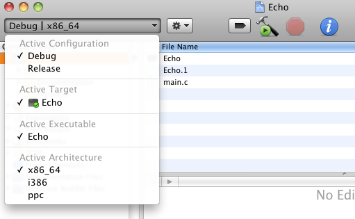

It should be in the left-most pop-up menu of the main window toolbar.
If it's not there, it can be recreated by going into Project | Edit Project Settings. Then in the Configurations tab, duplicating the current (Debug?) configuration and customising.

In XCode 3.1.2, it can be found in the Project menu, down a ways, under the "Set Active Build Configuration". Or you can pull down the Customize Toolbar sheet and drag the "Active Build Configuration" item onto the toolbar.
