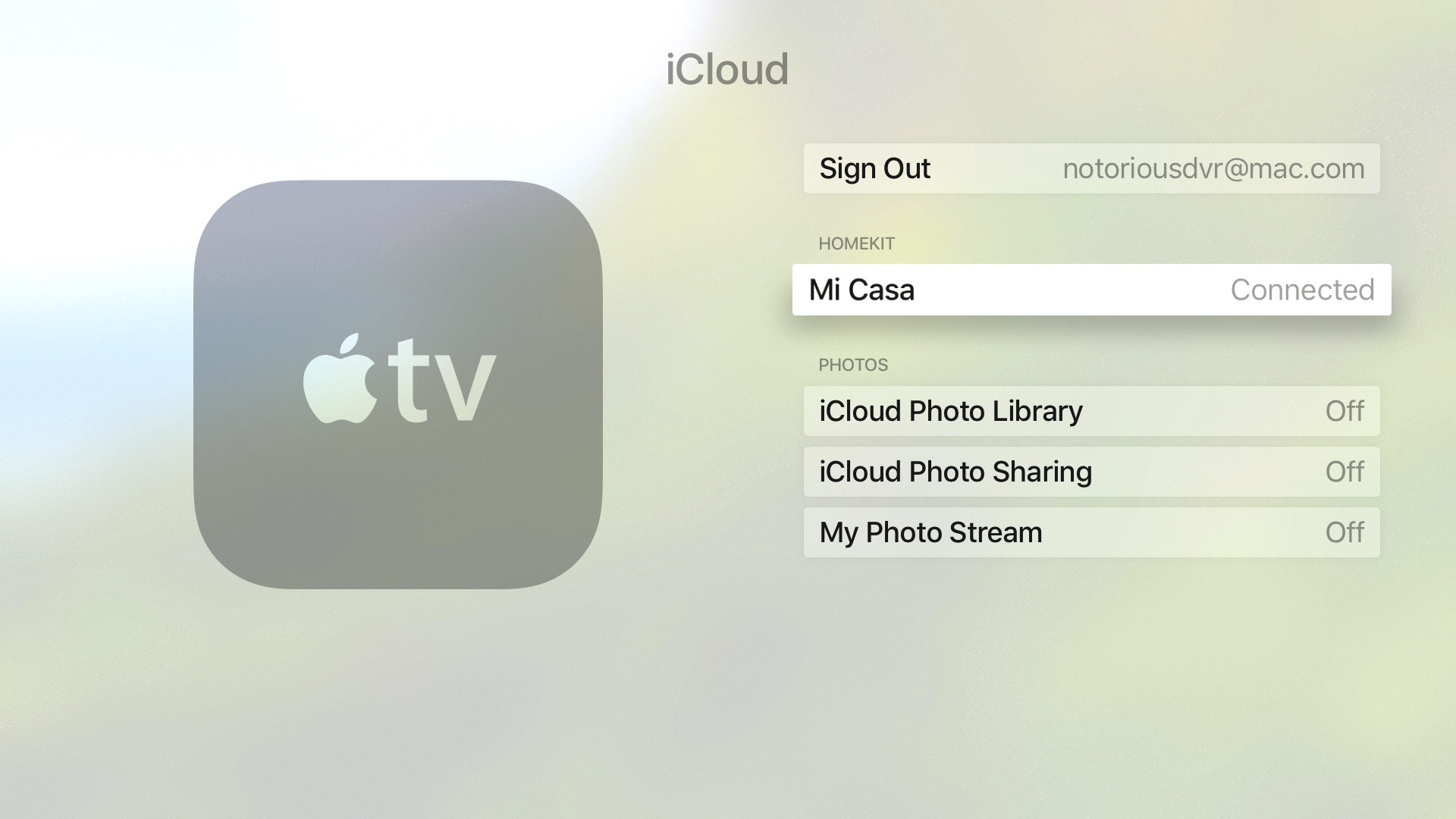

See the screenshot below. Email me directly at adam (at) elgato (dot) com if you'd like to troubleshoot further.
My ATV4 does not have the HomeKit Menu under iCloud. I have everything turned on and tried rebooting everything, i also signed out of iCloud and signed back in. I have a schlage sense lock and it works over bluetooth. Any suggestions?

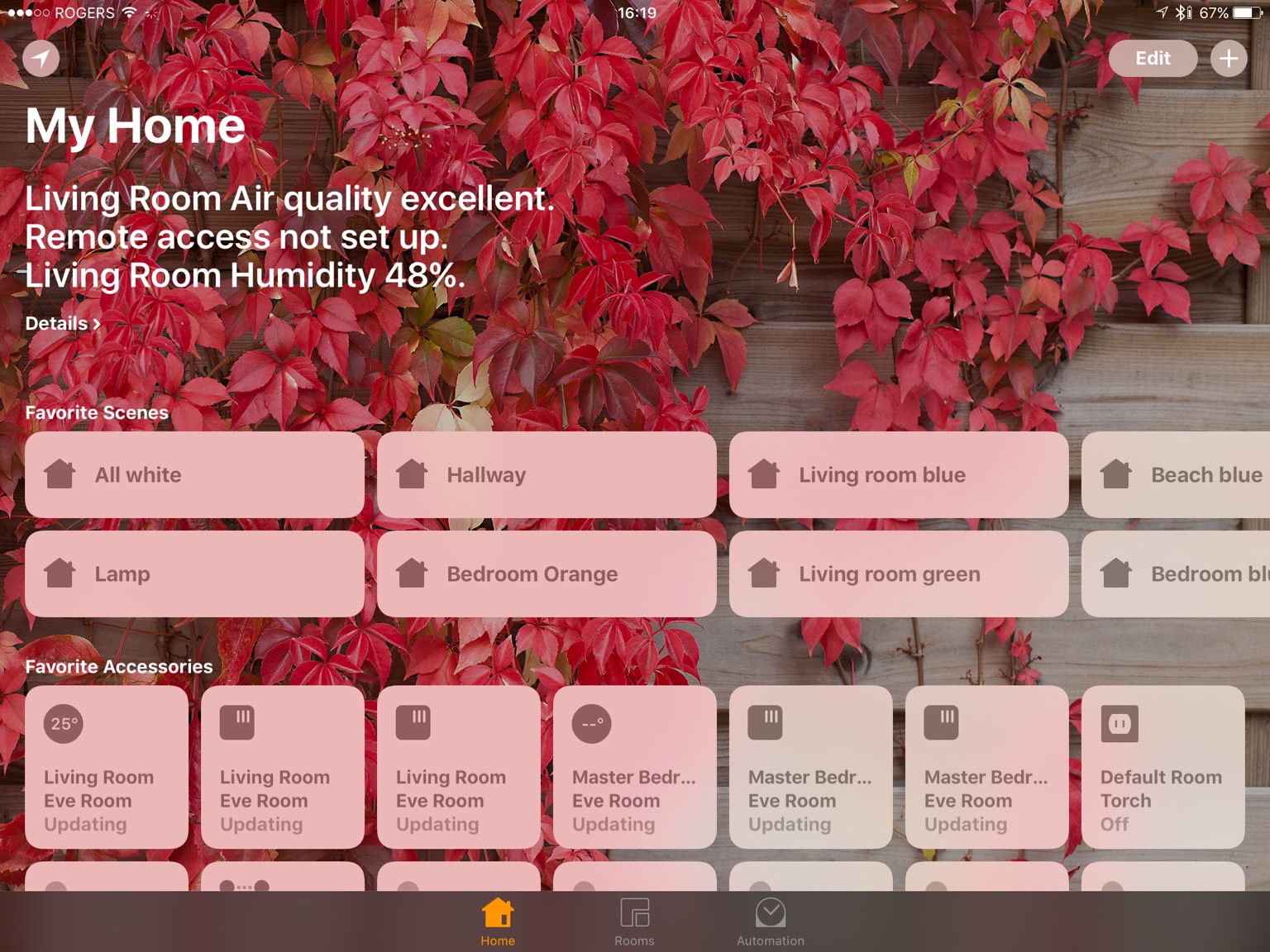

It looks like my remote access is working. I was able to turn off several Hue lights from a few miles away with no problem. Quick question though: is the Apple TV supposed to show up as a device in the Home app the same way the the Hue bridge does?

I'm still stuck. My Apple TV 4th Gen is clearly showing as connected to Homekit so it must be seeing the databut once I switch off wifi, the devices in the home app all show up as not responding. I've tried resetting the Apple TV, removing the Home and starting that again but still no luck. This is very frustrating!
