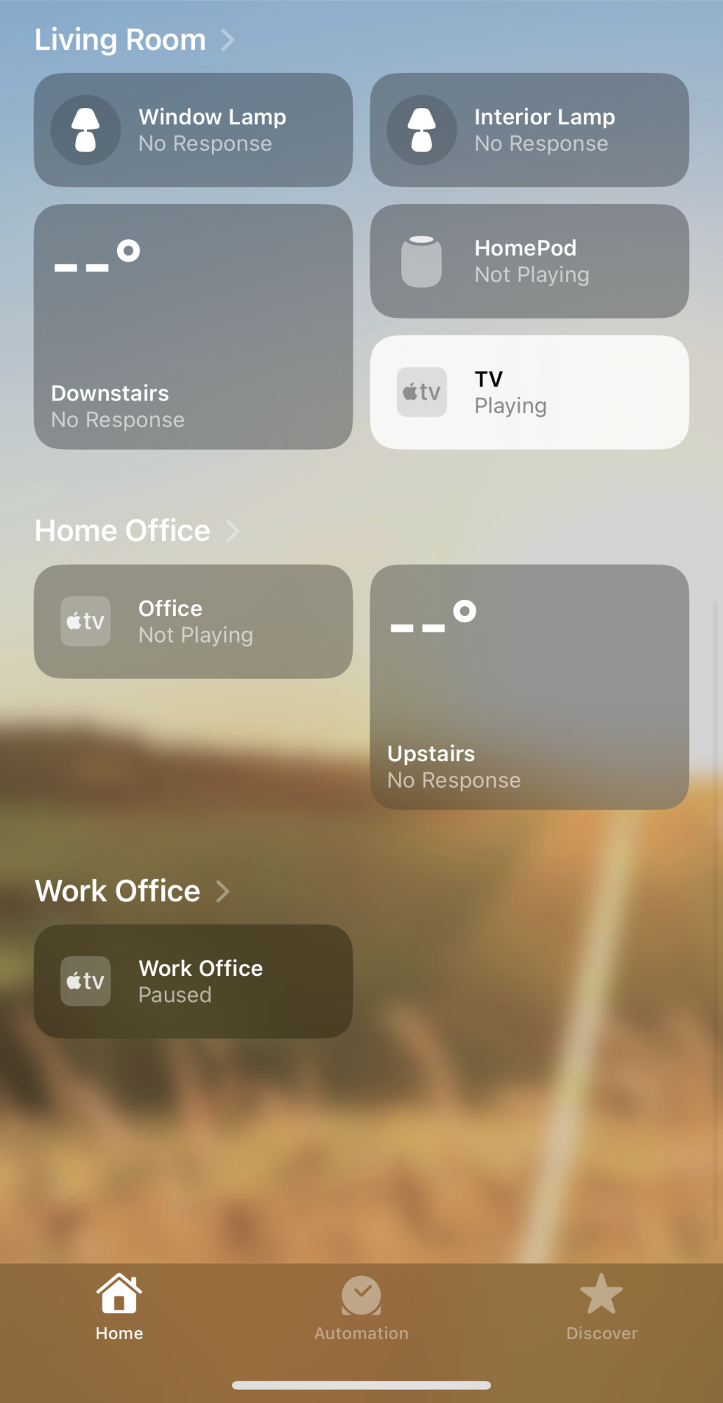

Has anyone had any issues with general HomeKit functionality since updating to the new architecture? I did the update on my end a couple of weeks ago and since then most of my devices haven't been working right through the Home app. Devices show up as No Response all the time. It used to be that I could play something on a HomePod and it would shake everything loose and all start working again, but now that's not working anymore. Siri commands work, but the app itself won't show anything other than No Response almost all the time (see screenshot). All of these devices are working fine in their native apps, just falling down in the Home app.
I have restarted my hub devices. I've made sure my router software is up to date. I've power cycled all of my network equipment. I really don't want to delete the home and start over with re-adding my devices, so I'm hoping someone else has a good idea for something to try.
