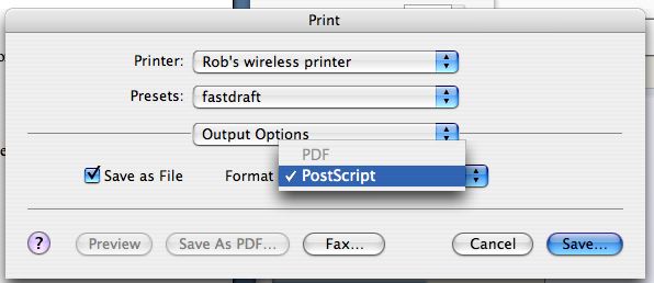

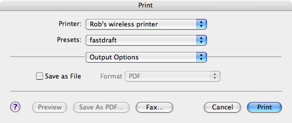

I need to email out an application form, which is currently a word document. I don't really like sending out word documents as you never know if they really are going to display correctly on the other persons computer, especially when presentation is important. So I want to convert it to a pdf.
At this point I'm feeling smug that I have a mac and its really easy, but my "Save As PDF" is greyed out, scrrenshot attached. After a bit of investigation it turns out that it is greyed out in every app I try. Is there any reason for this to occur, could I have changed a preference somewhere or something. I know it was there and working a month ago.

that's kinda odd... uhm.. try selecting "No Printer Selected" or something from the Printer drop down... see if that helps?

Nevermind: your screen shot is in the Print dialog
Wait, Your preview button shouldn't be disabled either, so I am guessing this has is your problem - since preview is converting to PDF.
Did you delete Preview or change permissions on the application?

Save As PDF does exactly the same thing in every app I have tried, text edit, safari and even when I'm looking at a pdf in preview!
The formatting pallet gives me some odd options as well. PDF is always grayed out (see the first screenshot), and is selected as the type by default but when I check the "save as" box, it automatically switches to postscript (see the second screenshot).

Just for kicks (if you have time) create another user account and see if you see the Preview/PDF print options while logged in as that user. If you don't, I would venture to guess either (a) something is missing (b) permissions are wrong and weren't caught by repair.
I am assuming you don't have the full version of Acrobat installed? If so, you can add an Adobe PDF printer.
You may also want to either delete and recreate your current printer, or add a new "dummy" printer. You can add a dummy printer by adding an IP Printing device - you can add it and select an HP or other color printer and see if that fixes it. Since both screen grabs show the same printer, I'm wondering if there's a problem with that driver.
Thank you, you cracked it, it's back when I try under another user account. Do you have any idea how I would figure out why it isn't working under my current account? I don't really want to shift everything across to a new user account, although I guess I could just set up another account for when I have to make pdfs.
