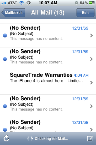

    It is rather strange, but since I updated to iOS 4.0 and set up my Gmail account for Mail and Notes via IMAP, everytime I check my mail on my iPhone, and later delete it on my Mac, the iPhone Mail App shows scores of unread emails, with as No Sender, No subject and no option to delete the same. Anyone else experience this? Any workarounds/solutions?

    me too happens with my gmail... do a hard reset it solves it temp

    What if you delete the account on your phone, reboot it and then recreate the account.

    I had this using the IMAP Gmail settings. I changed to using the Exchange Server settings and the problem has gone. However, you cannot search messages held on the server using the Exchange method, so you lose out that way.

    What worked for me both times was just killing the Mail app on the multitasking interface (tap and hold, then tap the red minus) and launching it again.

    Going to Settings > Mail, Contacts, Calendars > Gmail and then turning off Notes fixes it for me.

    I've had this problem. When I turned on threading (mail settings) it went away. It recurred twice and both times, turning threading off and then back on fixed the issue.

    I observe a connection between the no sender email and deleting other messages, particularly those which have images. When I click on an email and delete it before it is completely open, later while it disappears, it does not appear in my trash box. Later it appears in the inbox as an no sender message. I have had success by deleting an ordinary message, sometimes one I create for this purpose, then going to the trash box and using the delete all option under the edit function. All the no sender messages in my inbox go away.

    I found if you close the Mail App and restart it fixes the problem. Close it from the MultiTasking Menu.

    Here is temporary fix for NO SENDER issues
    1.) Press home button and Power button at the same time. Turn Power off. Wait 15 seconds
    2.) Press home button and Power Button at the same time again until you see silver Apple icon appears.
    3.) After your iPhone boots up, it should have removed all "no sender" emails.
    4.) It probably only last couple of days to a couple of weeks before you start receive "no sender" email again. If it happens again, just repeat the process above, until Apple will find a permanent solution.

    Couple thins I have noticed. I have lockInfo installed and i glance at all my incoming mail and I see the sender and subjects just fine. Then I go into the mail app and i get the no subject no sender. This tells me that its not an issue with our mail accounts but on the locally. No body seems to have any answers (just spent forever researching online). Hopefully Apple fixes this soon... some work arounds in the mean time:
    • Toggeling threaded messaging on and then off seems to help temporarily
    • for close the mail.app seems to help temporarily
    • leaving the inbox, going to another mail folder, and then back to inbox seems to fix temporarily
    Hope this helps...

    Apple posted a new support article today about this exact issue:
    http://support.apple.com/kb/TS3426
    Their solution is to kill the Mail app and start it again, or restart the device if you don't have multitasking.
