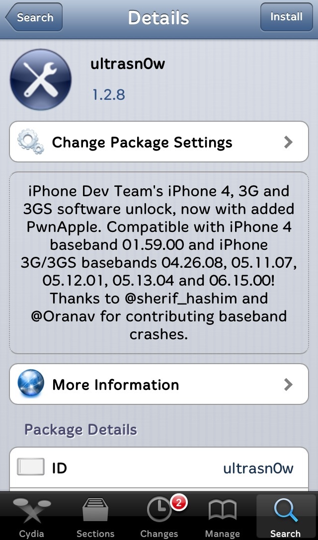

I just intall the 6.1.3 on iphone 4. Instaled cidya, ultrasnow and semitether. Put my sim in and no service. The pgone was locked to another contry... Unknown contry
I live in portugal
Model mc603j/a
Baseband 04.12.05
Baseband 04.12.05
I'm not too sure what the thread is about but according to the ultrasn0w page, that baseband isn't supported
ok...
I have an expensive and useless ipod with the shape of an iphone4....
will search for a way to downgrade baseband... if exists I will post it.
