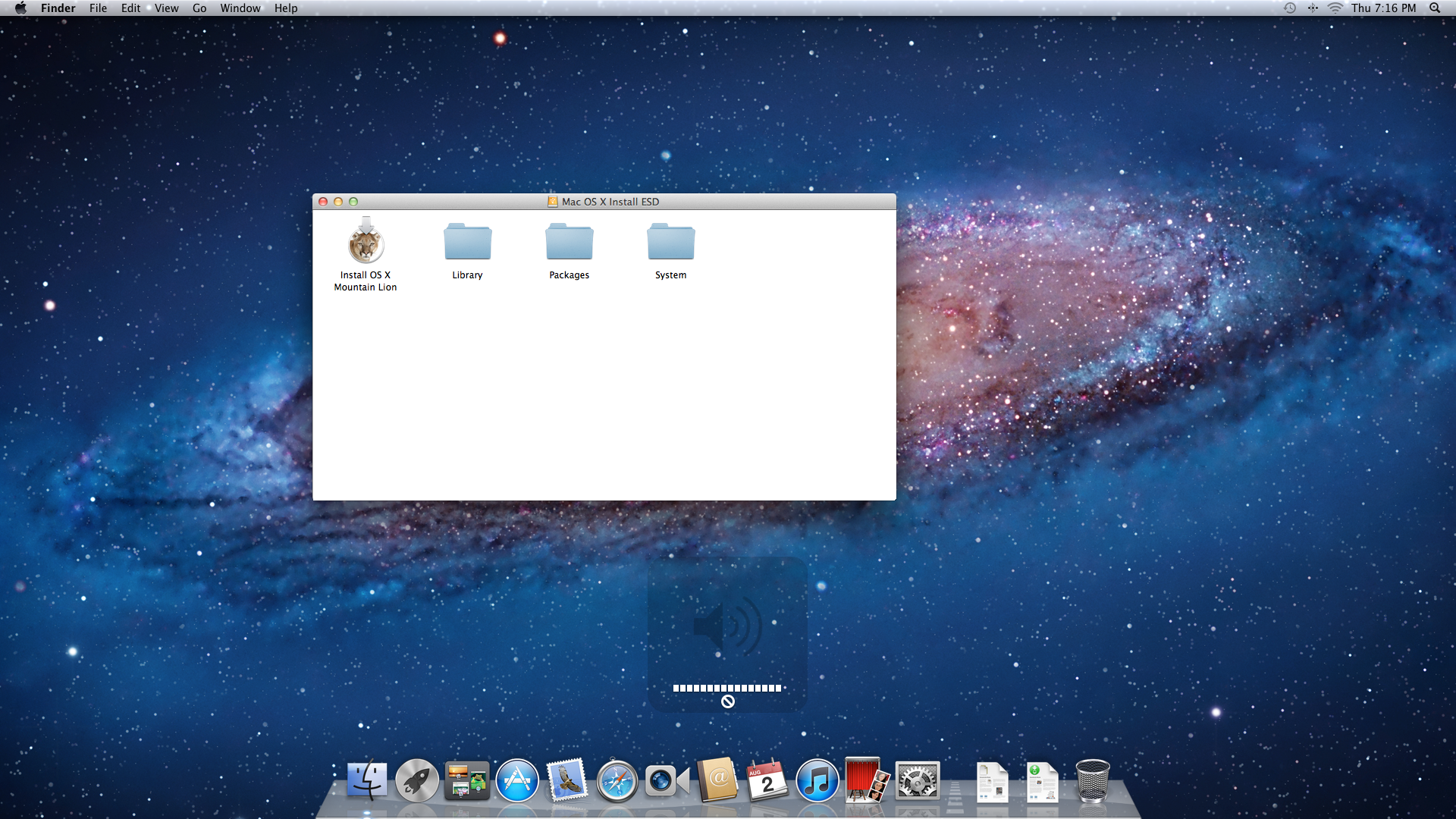

I have completed a fresh install of 10.7 just to see if that would fix it and it was also a no go. Fully updated etc, it seems like the problem almost expanded, now the volume controls don't work and look like the attached pic. It appears as though I will have to go to Apple tomorrow unless someone else has any other suggestions. Also, still seeing no output devices in sound prefs.

That is indeed what I was afraid of, luckily it is under warranty still! I wish the new models were out, might get lucky and receive one of those!
