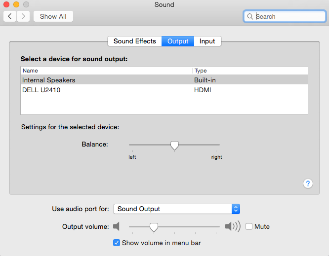

Mine was due to using HDMI out to my Dell 24" monitor. For some reason after installing the BETA OS X decided that the monitor was a good place to send the sound output 😕

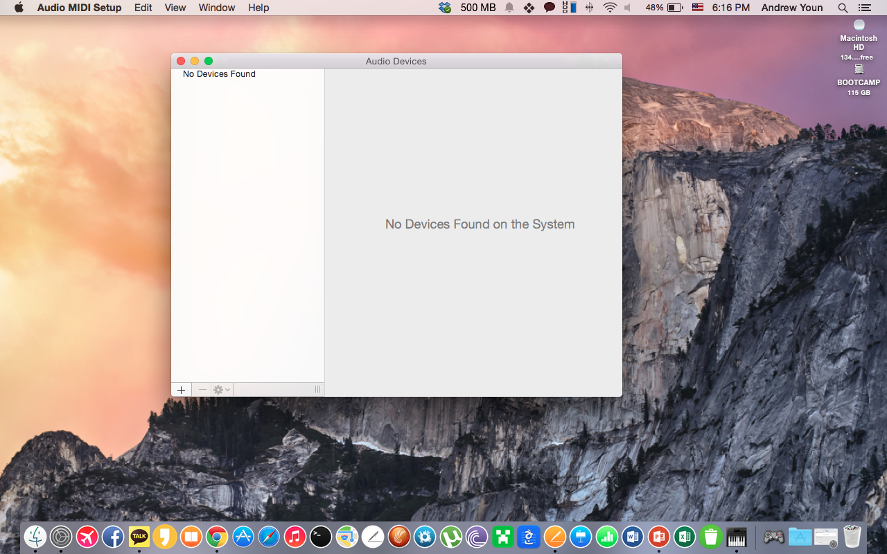

I have the same problems no output in system settings and if I open audio midi setup it doesn't even show my speakers there. As for the driver no such path exists. I'm on a MacBook air
Still problem
Ok i have tried everything here from every reply from instantonhaldriver delete to right clicking the internal speaker but in the audiomidi setup i have no speakers at all and even with the headphones plugged in there are no speakers
still no audio
