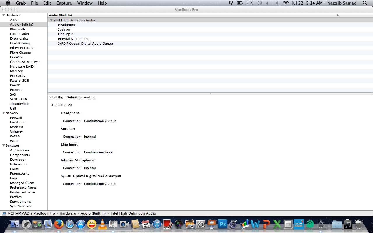

I do not have any audio output on my Macbook Pro when running on mac os. However, there is still the start up chime sound. It shows a stop sign when I tried to increase or decrease the volume. Sound panel shows 'no audio output'. No red led light from the headphone jack as well.
My MacBook Pro details are as follow:
Mac OS X Version 10.7.5

Currently...
My MacBook Pro detected the sound. All I did was...
shut down
switch on to safe mode
shut down
switch on resetting NVRAM (pressing Option, Command, P and R while switch on)
then the volume and sound control has been detected and working as usual...
