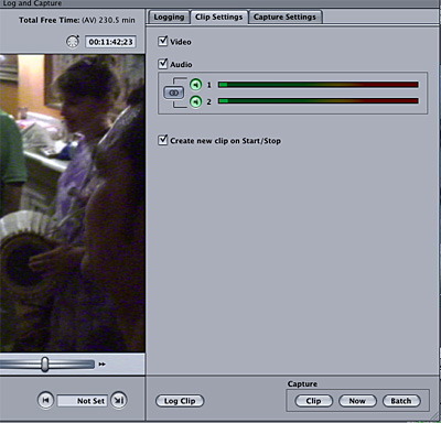

Here's an image of that tab with all the appropriate boxes checked.

Thank you, but here is my image (see attachment). As you can see it is different than yours. It doesn't have "Preview" check box.
Yes, audio IS being captured and I can hear it when I play file after I capture. I only don't hear it while capturing. I can live with that, but still annoyed that I can't find it how to turn it on.

Here is a very simple answer to my question - Log and Capture window/features differ depending on whether you are working on HD or SD project.
I was capturing HD video therefore my Log and Capture window looked different and didn't have audio preview check box. I guess it is not possible to preview your audio while capturing HD video. When I opened Log and Capture in SD project I saw exactly the same options as in Carl Spacler's image and was able to turn audio preview with no problems as Carl suggested.
