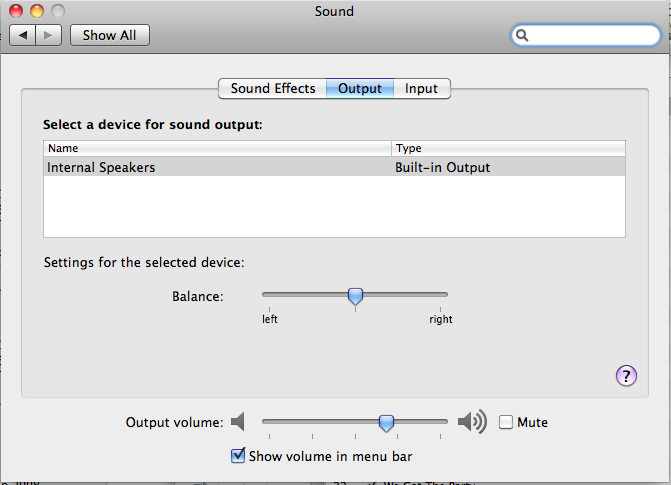

Hi out there, I have a 2007 imac 20", first of the silver ones. I'm running OSX 10.6.4. Suddenly have no sound 😕. I've had a browse of a couple of threads, but am none the wiser. The speaker icon, top right is greyed out. When I moved the mac, it did provide an intermittent burst of sound, but have not been able to repeat that. Plugging in external speakers does not make a difference. Using the sound up and down controls not helping, just get the normal sound display, but with a stop sign below it (circle with a stroke through it). Is this a return to store job - as out of warranty and out of applecare!😱

Go into System Preferences > Sound > Output and take a screenshot and attach it via the
button to your next post.

To make smaller screenshots (for future reference):
It seems, you digital output is active, there should be a red light visible inside the headphone/line-out port. Plug a 3.5mm audio connector into that port and pull it out, repeat the process until the red light is gone. It should take less than ten times.

Can you provide screenshots of when the speakers are connected and when you have them disconnected, using the internal speakers?
Shift + Command + 4, then leave the keys, press Spacebar and select the window via mouse.

Yep, one shot with the speakers plugged in and one without.

Hi thanks again: first is without speakers: the second is with
