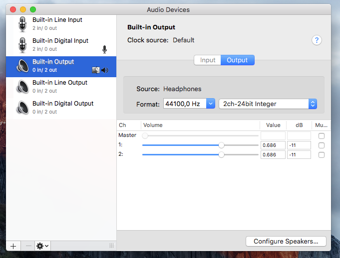

I have removed the card(Blackmagic) but nothing again.When I run the Audio Midi Setup(in Utilities folder) as Built-in source has headphones.I will post a pic from Audio Midi setup if it is help.
