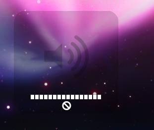

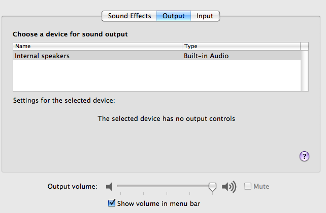

    I have no sound while running Leopard...everything is standard in my Powerbook except memory which is 1.5 GB. 17'' Powerbook 1.67 GHz.
    Any help would be greatly appreciated.
    Here are some screens of my problem:

    This happened to me on my emac g4. Basically I had to make sure the output was set to the right output and then I had to adjust the volume in the system preferences. I'm not sure what exactly did it, but it worked.

    That's the problem...it's all grayed out in System Preferences. I can't adjust the volume at all. I don't know what's going on.

    I'm not sure then. Did you try adjusting on the sound effects panel as well? I did that. For some reason, my output device and sound effects devices were set to usb. Yours isn't though.

    It's grayed out there as well...I can change the alert volume, which does nothing, but I can't change the output volume.
    This is irritating...
