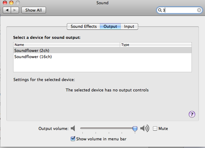

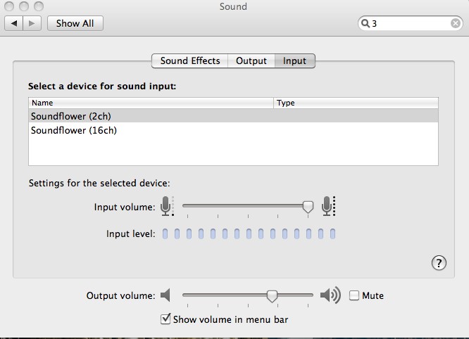

when i go to pref>sound> there is no choise of internal speakers, and it doesn't recognize plugged in headphones or ext speakers.... pref>sound>output> the selected device has no output controls
it shows only soundflower as option

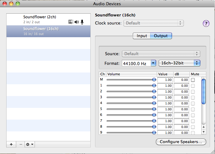

It looks like Soundflower has grabbed the audio and isn't configured correctly.
You can go to "Audio MIDI Setup" in the Utilities folder (Applications > Utilities > Audio MIDI Setup) and select the built-in Output there.

Thank you for responding, when i open audio midi setup, there is no option for built in speakers...

after rebooting, and another permission repair, it opened the sound pane, with again only two options soundflower 2 ch 16 ch...
There is no option anywhere for built in, and also for option "output" the selected device has no output controls..

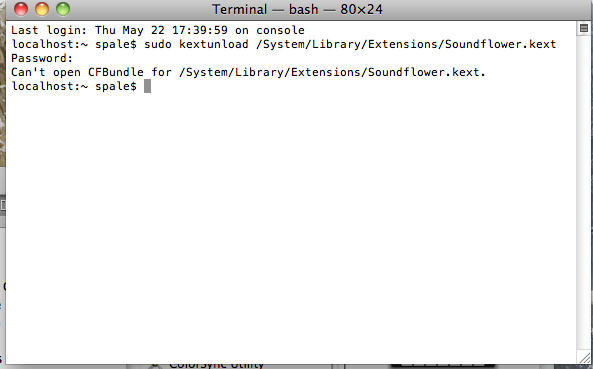

so the commands dont work... :/
i did the similar copy paste thg before
and this is how my audio midi looks like
It looks like you may have a corrupt audio kernel extension. There should be a listing shown for the internal or digital output on that Preference Pane.

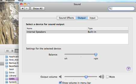

Unplug the headphones and ensure that the audio is not muted. You should now also get sound through your speakers.
