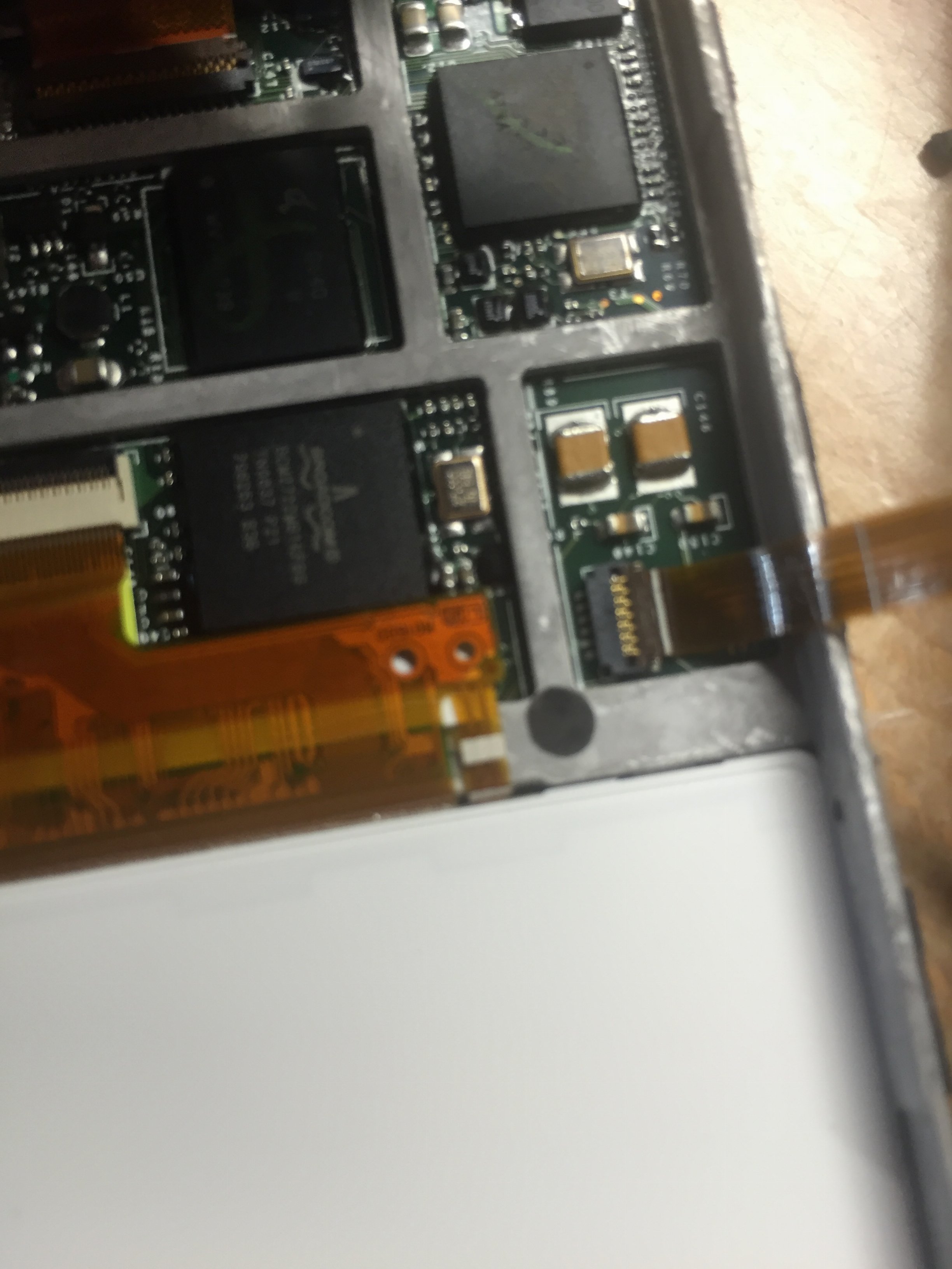

It looks like it is sitting in there correctly, I un did it an reinstalled is and it all seem correct. I am assuming that the hold switch function wouldn't work if it was miss installed
Double check the entirety of the ribbon cable, checking for any kinks or tears. I have managed to slightly tear one of these before, and it only killed off the left sound channel, so give it a go.
