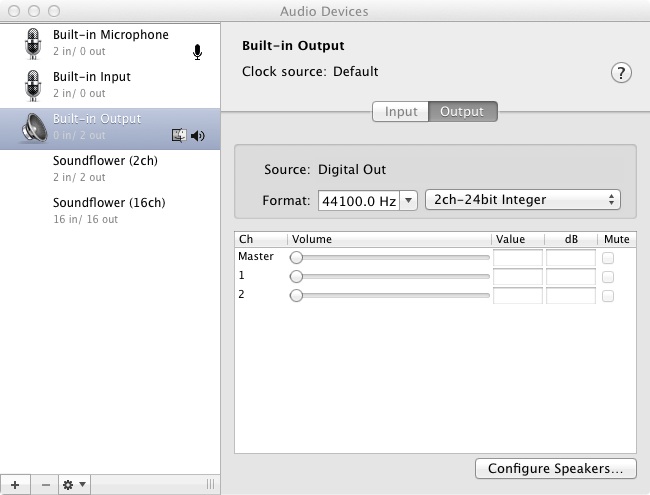

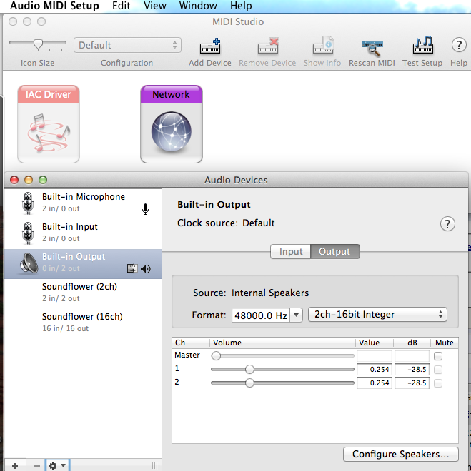

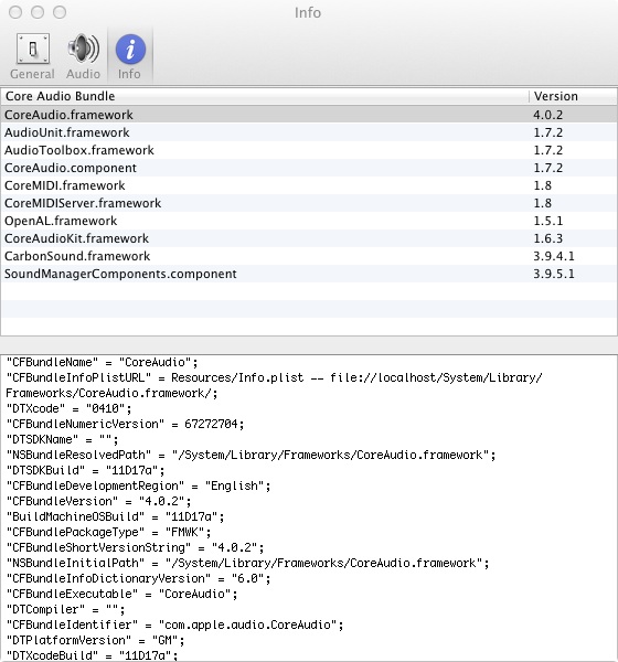

I tried to change some settings in the audio MIDI settings, but now nothing works at all.

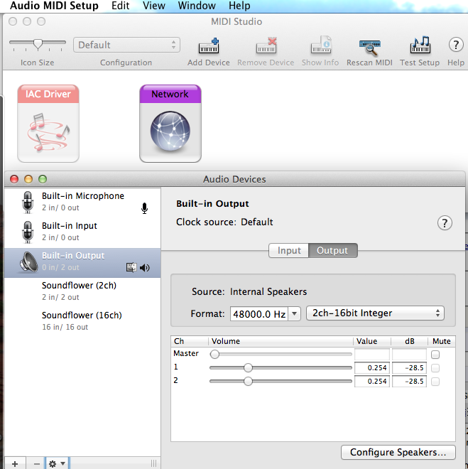

Try Posting a screen shot of the apple audio-midi-setup "audio devices" window and "MIDI studio" window.
I have attached my settings from my Macbook Pro. Note that I do not have any audio sources attached to the Macbook Pro at the moment, so my settings should be the default settings, minus the soundflower headings. Soundflower provides a means of piping audio from one program into another, one output to another, etc. Soundflower is installed along with plex, I believe.

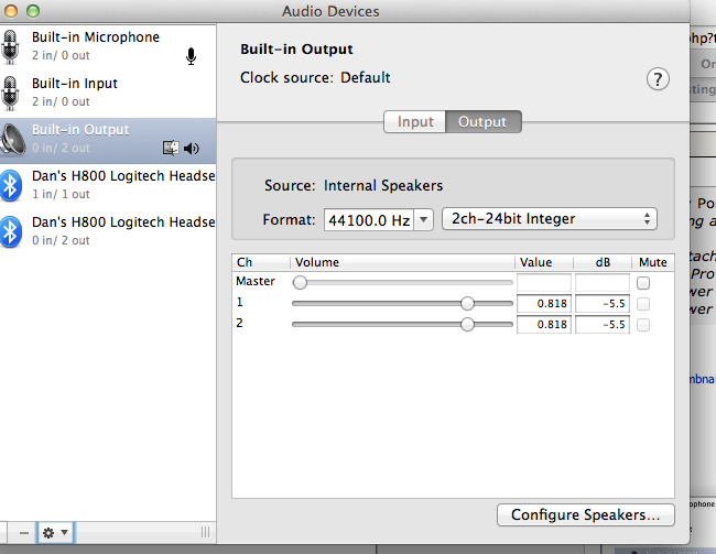

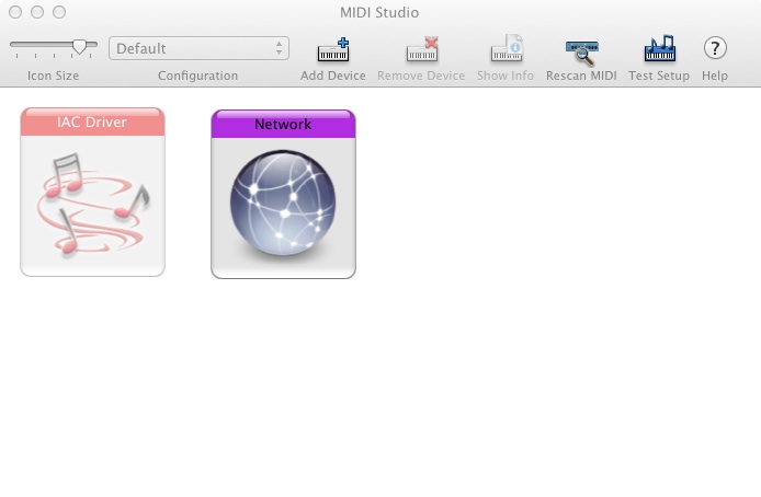

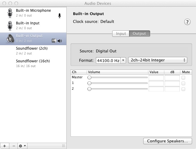

heres mine...
Here is mine with nothing attached and I have values for 1 and 2 under the settings. Sorry no cable to test the Digital Out defaults.
