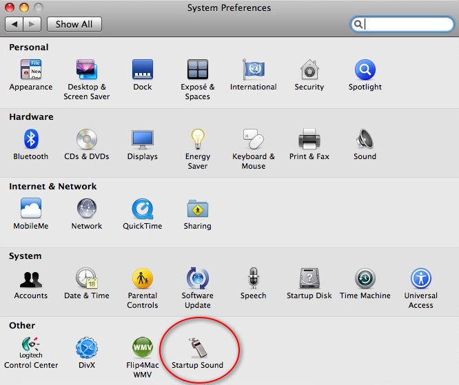

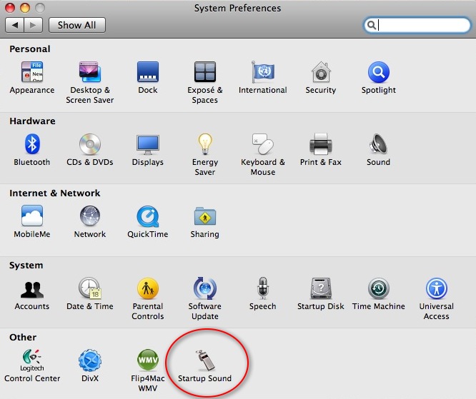

Might you have this installed?
Volume is set to middling, Soundstick speakers plugged in. And no, I do not have that extension thingy.
