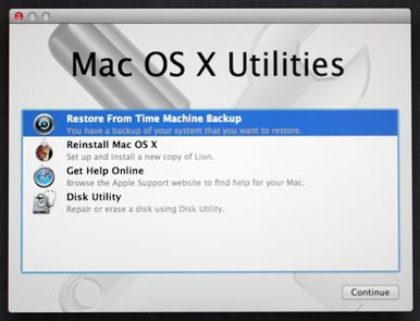

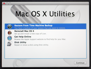

This photo is from Google, but it's basically what comes up as soon as my iMac boots up (obviously mine says Mountain Lion, not Lion).
I've attached an image, not sure how to post directly into a reply if that doesn't work.
It's right there under your nose.😛
ReInstall OS X, that's what you have to choose.
It will then download a copy of OS X Mountain Lion and Installs it.
Oh yeah, now I remember, it's the recovery HD, it's still there on a partition.
Ah see i've tried that that's the problem. I click re-install a fresh copy of Mountain Lion and its starts up fine asking to agree to the Terms and Conditions, then turn my WiFi on and connect to internet, then sign into Apple ID, start the installation. It says it will take about 8 minutes to install, then it will restart. The 3 times i've tried it, the installation box disappears and then the OS X Utilities box pops back up. So i then restart the system to see if it worked and nothing.

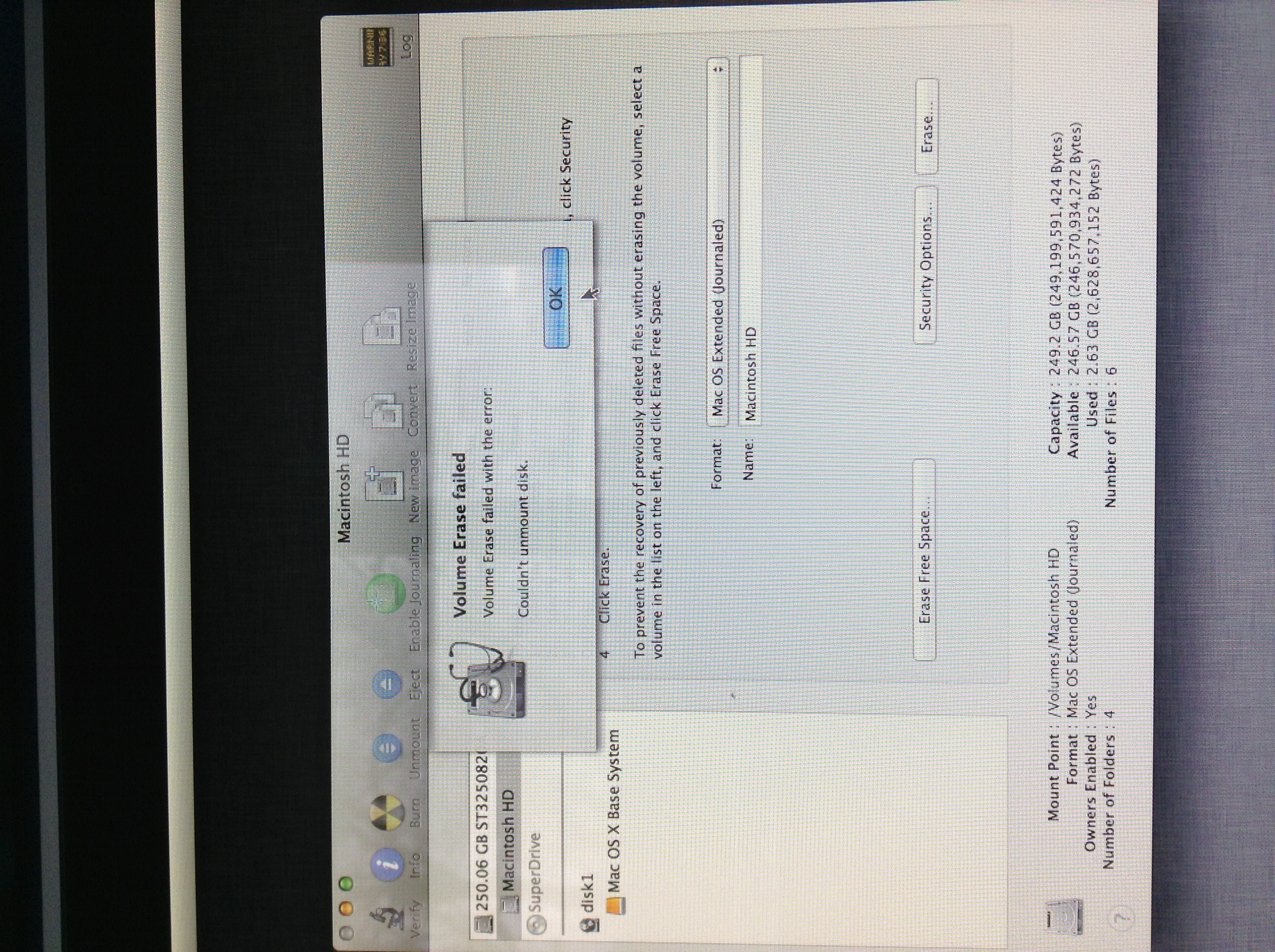

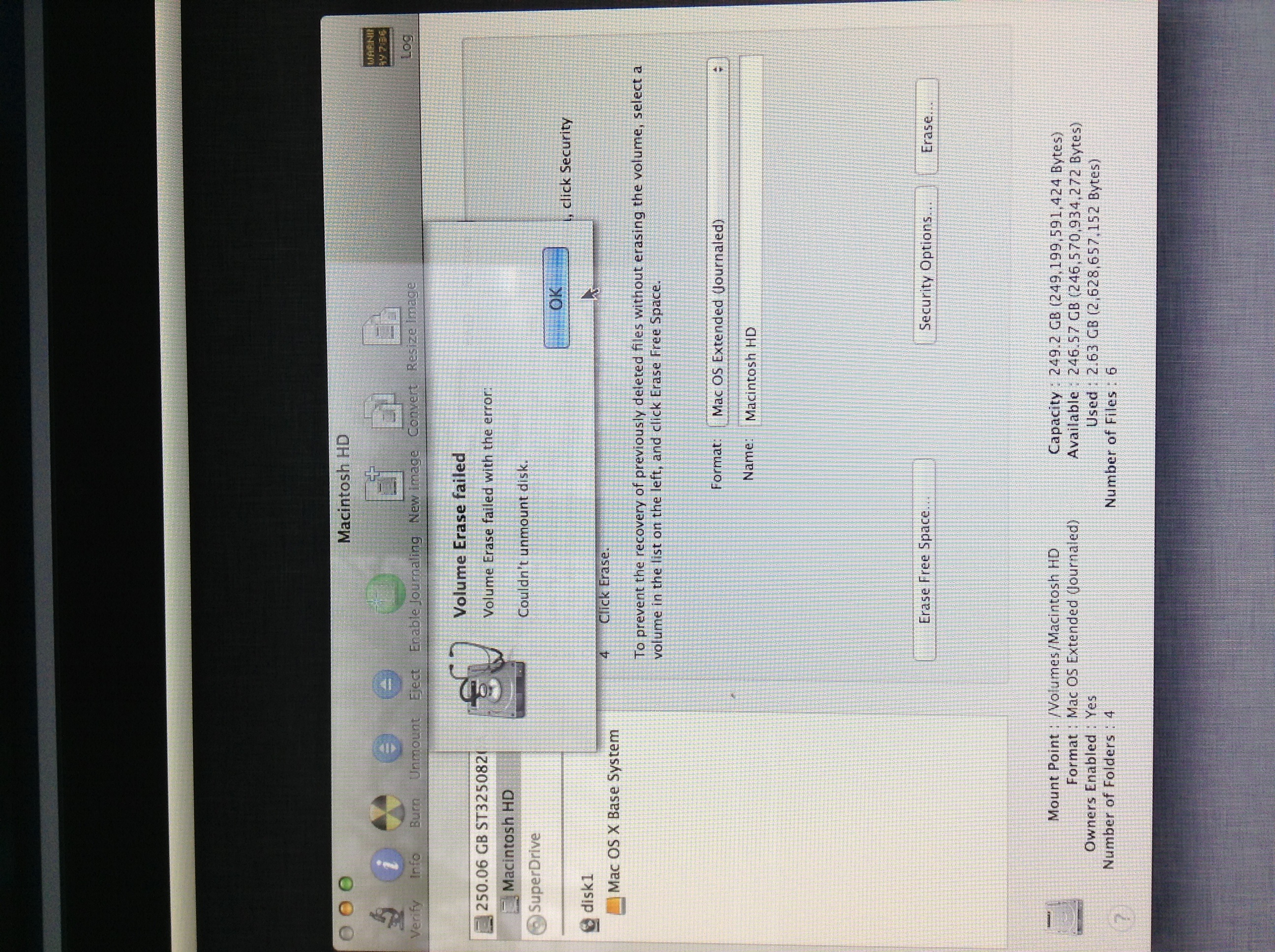

Ok so i'm home and just tried to erase the Macintosh HD, and i can't.
This attachment shows the error i get:
Did you do a command-r boot and are you in that recovery screen like in post #5 above? Your screenshot shows you are running off Macintosh HD and not Recovery HD.
Did you do a command-r boot and are you in that recovery screen like in post #5 above? You screenshot shows you are running off Macintosh HD and nor Recovery HD.
Command + r takes me to the same screen i get on start up.

Okay so i restarted the computer, now that error doesn't pop up. The Macintosh HD has been erased.
It seems to be going good on the install!
Says it will take 48 minutes to download
That sounds more like it! 😀
Let us know how it goes.
