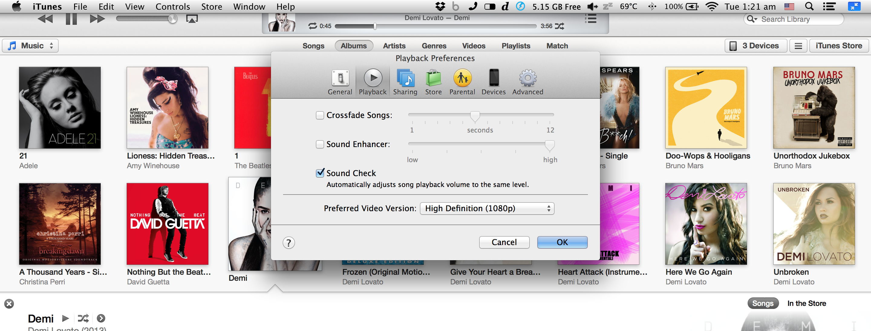

I can't find the up sampling option, can somebody yell me whats going on?

You think 44.1K sampled music will sound better if played at say 96K? How does this work? Where does the added information come from? The mastering process has already dithered the file for 44.1/16 playback. You can't recover the data.
Ok If you want to try it go into the Audio MIDI Setup app and set you output device to a higher sample rate. The sound always comes out at whatever the output device is set to. You can't change an output device in iTunes because the output device is system wide.

Thank you. I found out I need to set my thing to 384 kHz since my DAC supports it. I use the hiface 2 by M2Tech.
