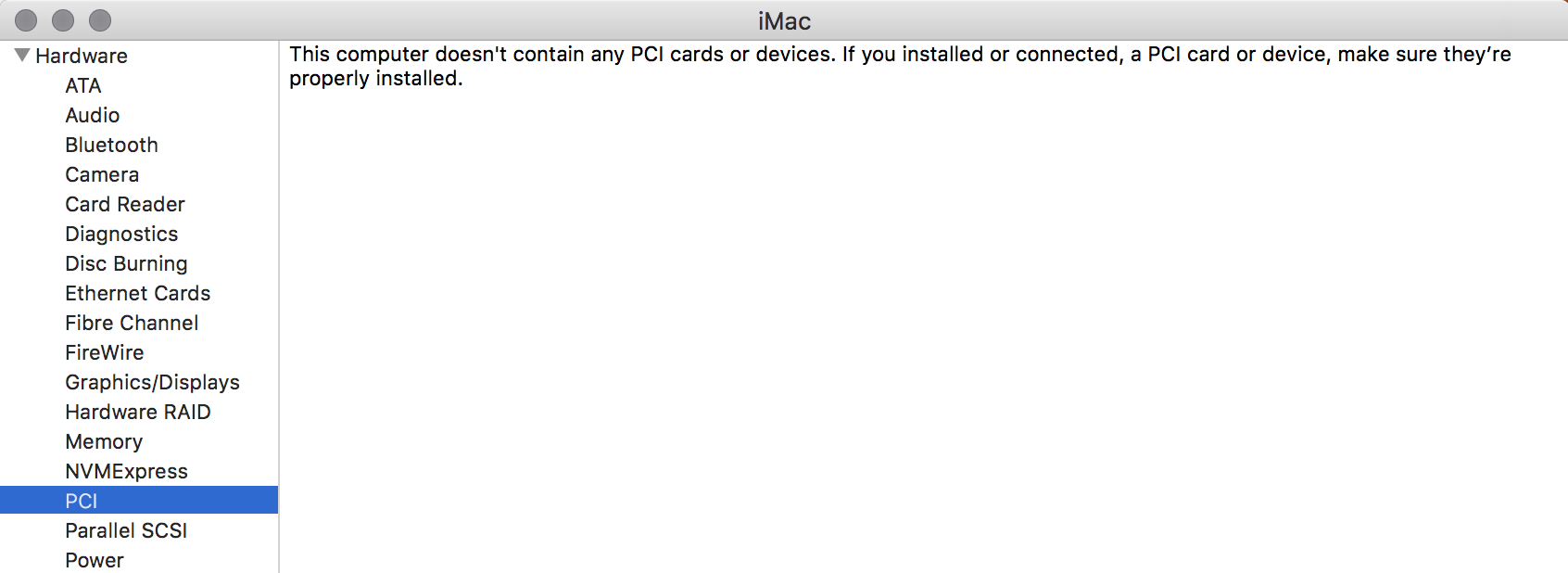

When you look in system report it's not showing up in the PCI tab at all? As in the screenshot... (I'm on an iMac right now, so nothing is there.)
