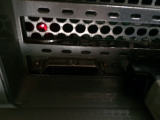

I just added a second 80GB 7200RPM MDD to help speed it up a tad, but when I booted into my Tiger install on the original 60GB HDD I had some issues formating the drive. It kept throwing me errors saying it couldn't unmount the drive and even said my password was wrong a few times (I don't even have a password on this machine). So I figured I'd reboot it into target disk mode and format the drive via firewire 800 on my PowerBook. It booted to TDM but shown no display and only mounted the 60GB drive. I rebooted the MDD to go back into Tiger and try again from there, but no video. This MDD does have a dead PRAM battery, but I've never ran into this before.
The PowerBook G4 I'm typing this on also has a dead PRAM battery and has never had an issue not showing the display on boot.
I tried reseating the video card and that did nothing. But I did notice a red light glowing inside and the mouse laser does not light up nor the caps lock key on the keyboard

trust me we have all been there LOL *switches on G5* nothing... Huh... Oh forgot to plug the power cord in *switches G5 on again after plugging in cord* solid white light no bong... Huh... some head scratching Oh I forgot to put the ram back in that I stole from it for my other G5... (I have also forgot to put the Fans back in a few times after changing the ram LOL)
Welcome to the club, everyone falls victim to upgrade focus madness.
Believe me.... When I swapped the DC IN board in my DLSD I put it all back together, I played some music to test(the sound didn't work before) and I was like "Huh, theres no audio coming from the left side" I look down at my desk and the speaker is just there... I was so mad at myself lol, I had to take the whole thing apart, and then I decided to finally fix the latch
Well there are more fun ones like taking an iBook apart and forgetting to slip the speaker cords together before you put all the screws back in, then test it.
Or how about muting it and forgetting that it was muted trying to find out why thee is no sound?
That lime green iBook I have had no sound in OS X , when I did clean install of 10.4.11 it came back , and no issue in OS 9 was really strange. Im thinking a bad kernel or downloaded off the net botched install on that one.
